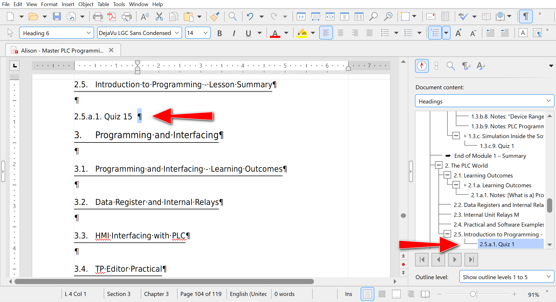

Greetings,
As shown on the attached screen capture, you will note that the "Document Map" shows the heading "2.5.a.1. Quiz 15" as "2.5.a.1 Quiz 1". Note that there is no obvious reason (at least to me) why the heading should be truncated, and I confess it worried me when I first noticed it. Also, this is but one example of the problem.
Is there a justification for TextMaker's behavior that I'm missing, or is it a wee bit broken?
Thanks in advance.

Posts: 3793
Re: Possible Bug: "Document Map" Unnecessarily Truncates Headers
Please share the correct file to reproduce this problem. Seems, you attached a wrong file which is a template.

Dear Super,
Thanks for the reply.
I attached a template file instead of the document file because I thought that it was all that would be needed. Also, the actual document is quite large, tedious, and constrained by copyrights. Sorry for any inconvenience.
I used the template to create a demonstration of the issue I am having/causing and attached the document to this post. Do let me know if it suffices.

Posts: 3793
Thank you for sharing this sample file. I have forwarded the details.
Posts: 3793
Our developer team have fixed this problem in next service pack.
