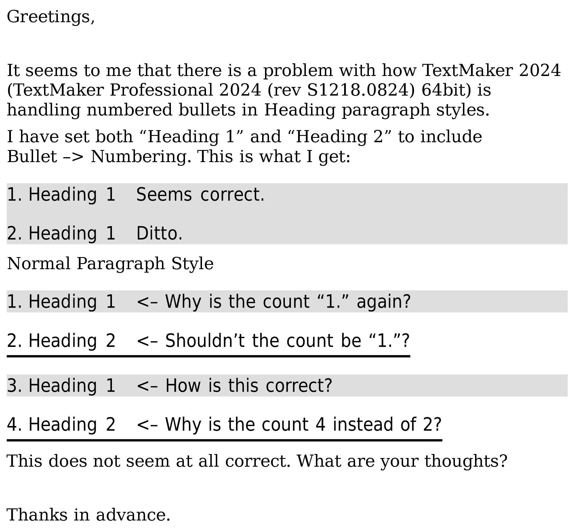

It seems to me that there is a problem with how TextMaker 2024 (TextMaker Professional 2024 (rev S1218.0824) 64bit) is handling numbered bullets in Heading paragraph styles.
I have set both “Heading 1” and “Heading 2” to include
Bullet –> Numbering. This is what I get:
[attachment=1]Subj Heading Bullet Numbering Issue1 - Excerpt.png[/attachment]
This does not seem at all correct. What are your thoughts?

Upon reflection, I believe that TM is handling heading numeric-bullets and ordinary paragraph numeric-bullets identically, even though this is not something anyone would ordinarily want. It's almost inconceivable that someone would have identical heading levels follow each other sequentially as is often done with numeric-bulleted lists, which means that it is almost inconceivable that the
Page Setup --> Chapter --> Page Numbering --> Options --> "Include heading number"
option would be of any use to anyone. Or am I missing something?
Another problem (for me) seems to be that TM continues to number bullets across even radically different contiguous paragraphs styles and "outline levels" instead of starting bullet numbering fresh at the start of every different numbered bullet paragraph style/level. In fairness, this is how numeric bulleting is described at
https://help.softmaker.com/textmaker202 ... lists.html
It is also quite regrettable that one cannot restart numbering within a contiguous string of numeric-bulleted paragraphs (and that this is not mentioned in the aforementioned help text). Changing the "Number Starts With" option of a numeric-bulleted paragraph seems to affect the first paragraph in the contiguous string, rather than only the paragraph selected and those that follow.
Considering that I created several different versions of numeric bulleted "normal" styles (e.g., some with "keep with next", some without, etc.), I can see how I'd be screwed almost however TM worked. Of course, this also means there are at least some ways TM could have worked whereby I wouldn't have been screwed -- I don't know why no one anywhere ever tries the latter choice.

This feature may be useful to some users, but if it doesn’t apply to you, feel free to ignore it.RKanarek wrote: Sat Sep 07, 2024 10:10 am Page Setup --> Chapter --> Page Numbering --> Options --> "Include heading number"
Please try this here also:RKanarek wrote: Sat Sep 07, 2024 10:10 am Another problem (for me) seems to be that TM continues to number bullets across even radically different contiguous paragraphs styles and "outline levels" instead of starting bullet numbering fresh at the start of every different numbered bullet paragraph style/level. In fairness, this is how numeric bulleting is described at
RKanarek wrote: Sat Sep 07, 2024 10:10 am Update: I think the solution to my problem is switching to "Numbered Lists" rather than numbered bullets,
I have forwarded this improvement suggestion.RKanarek wrote: Sat Sep 07, 2024 10:10 am It is also quite regrettable that one cannot restart numbering within a contiguous string of numeric-bulleted paragraphs (and that this is not mentioned in the aforementioned help text). Changing the "Number Starts With" option of a numeric-bulleted paragraph seems to affect the first paragraph in the contiguous string, rather than only the paragraph selected and those that follow.
Yes, that's the correct way.RKanarek wrote: Sat Sep 07, 2024 10:10 am Update: I think the solution to my problem is switching to "Numbered Lists" rather than numbered bullets,
This option will make that paragraph style numbering incompatible/non-numerable, which can be useful for some user. If not for you, please ignore this option.RKanarek wrote: Sat Sep 07, 2024 10:10 am Another even smaller discovery I seem to have made was to resolve the purpose of the "Skip Numbering" option in the
