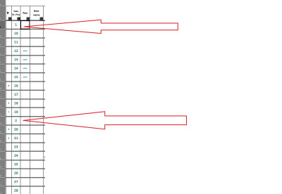

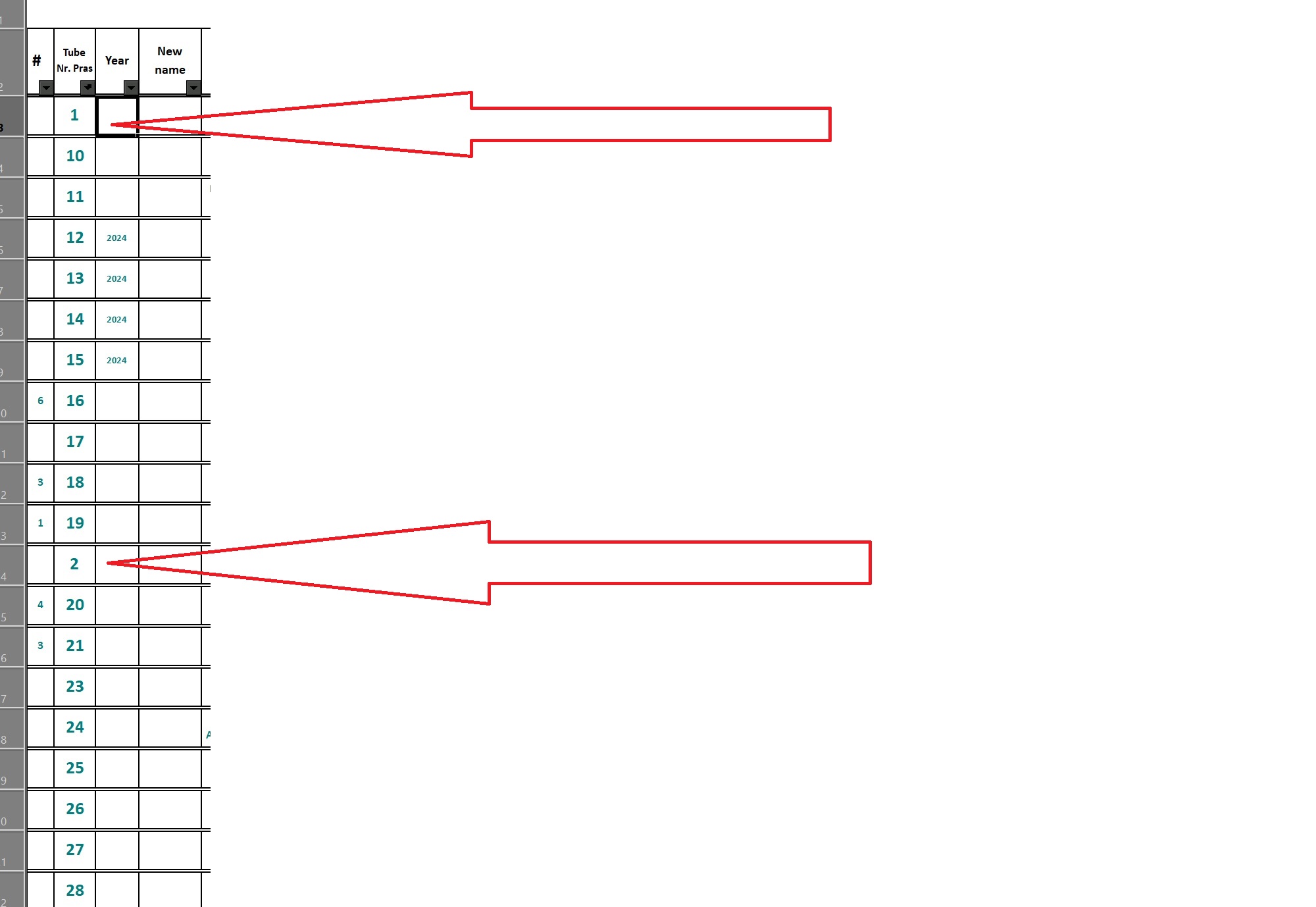

I am making a stocklist on which each item has a location number. I made the list random because I planned to order it by using the autofilter-sort funcion.

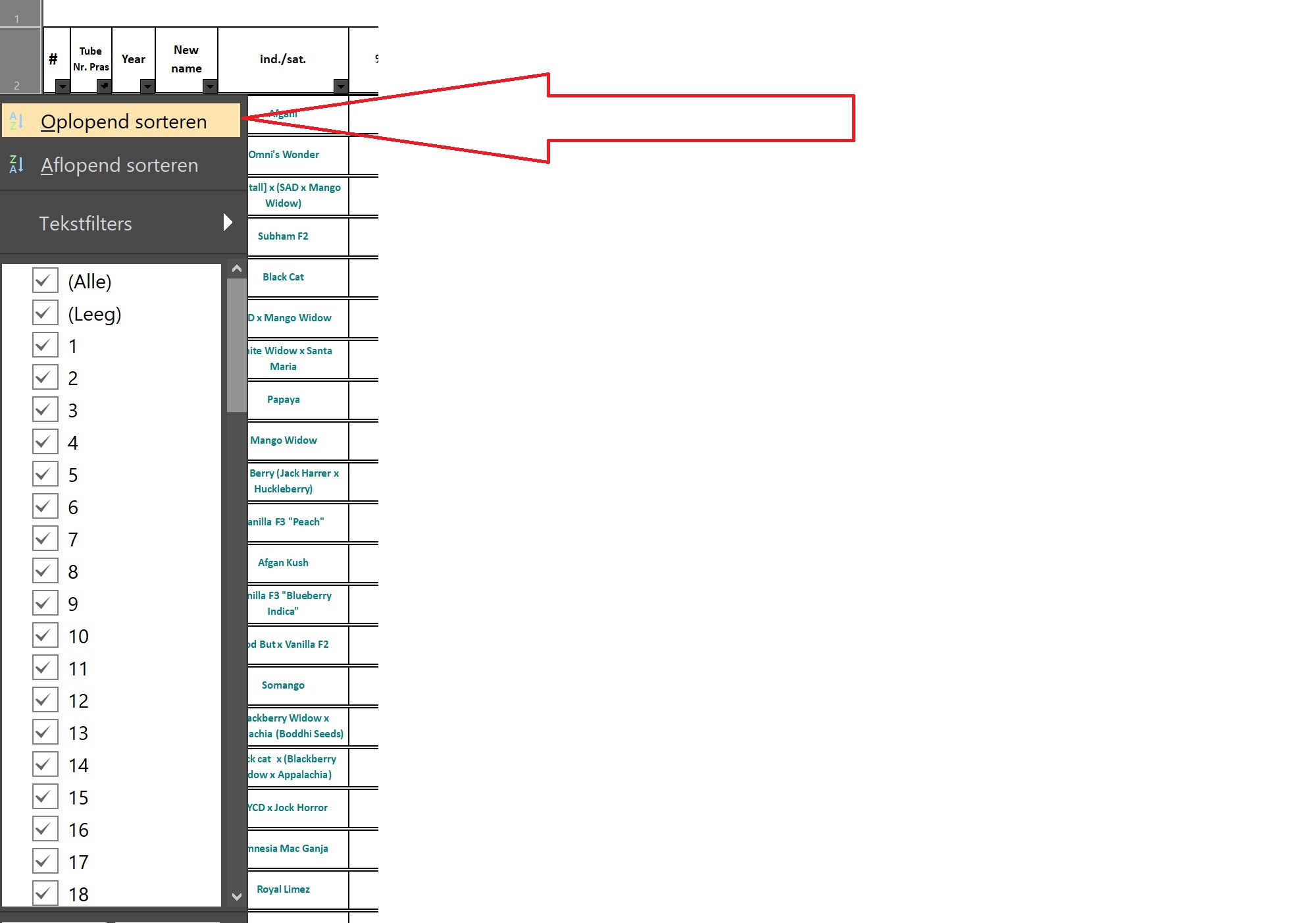

I now encounter the problem that the autofilter-sort funcion does not sort in a way that for me would be logical because it puts, for example,1 before 10, 2 before 20, 5 before 50, etc. (see atachment)
So how can I sort in normal folow-up of numbering, that is to say 1 to infinity would just folow up in sequence?
Many thank in advance for your reaction!

Thank you for posting your problem. It appears that this column is currently formatted as text rather than as numbers. Please change the format to 'Number,' and it should sort correctly.

To solve this problem, we need to correct both the cell format and the content format.
To do this, please copy the content of the column, then use 'Paste Special' and select 'Unformatted Text.' This will ensure that the content matches the cell formatting as 'Number.'
Please find your corrected file attached.
