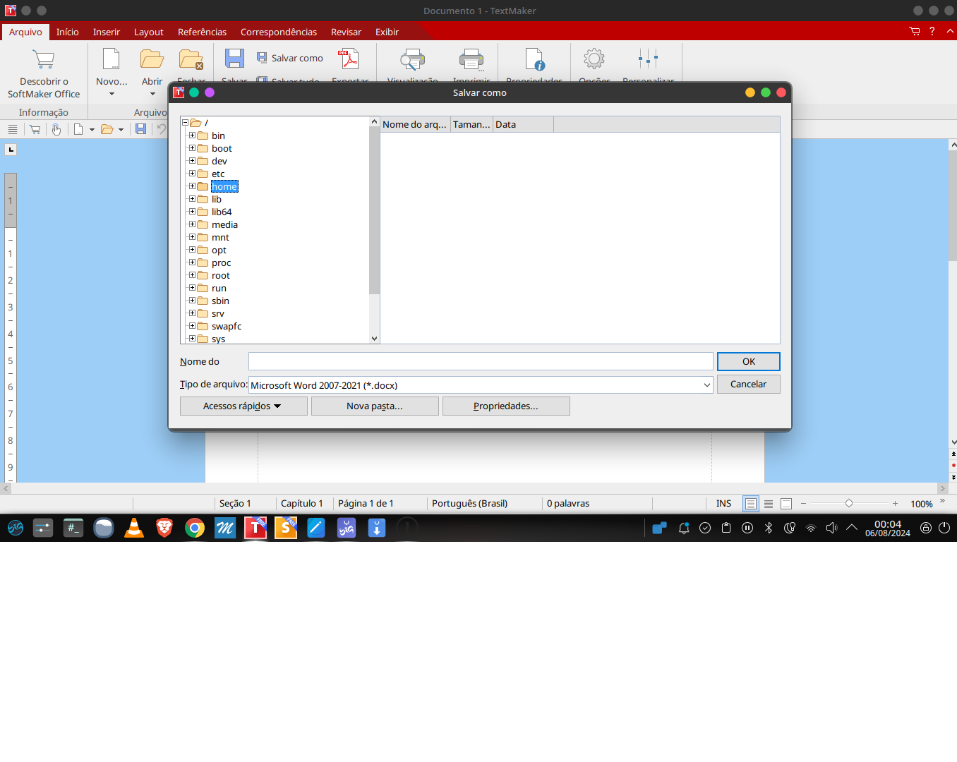

I use Biglinux Kde, and I use Freeoffice 2021 as a text tool. What I'm about to report only happens with freeoffice here on Biglinux or, perhaps, only on KDE. I've tested it in gnome and it doesn't happen. If anyone can help me, I'd really appreciate it.

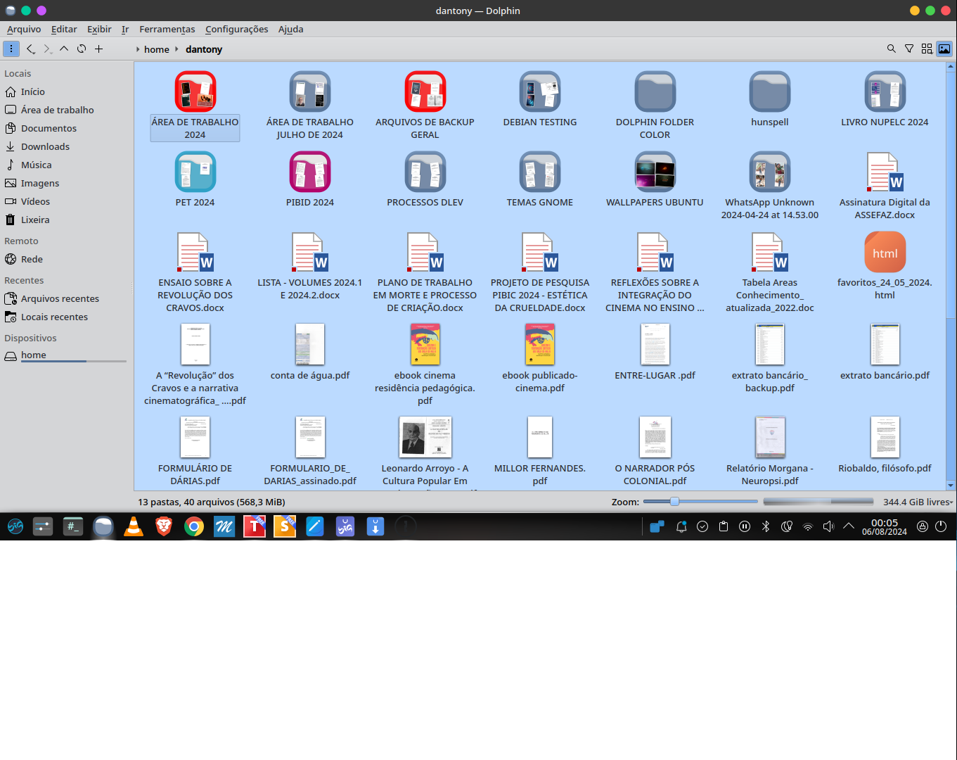

The problem: every time I save a file with freeoffice, in "save as" here in Big-kde, instead of taking me to that Dolphin page whose interface is the same as Dolphin's, the window that opens is one that takes me to yellow system folders. And it's very difficult to find my "home" folder all the time, which is on my internal slave hard drive, since the system is on an SSD.
In other words, it seems to be a difference between the FreeOffice save dialog window and the standard KDE window, as a colleague from another forum who tried to help me said.
How do I make it so that when I click on "save as", the window that opens is the same as when I open any file in Dolphin? How do I configure FreeOffice to use the standard KDE file dialog windows, in this case Dolphin?
Below is a printout (or attachment) of the window that opens in freeoffice (with yellow system folders) and a printout of the dolphin window, the one that is present when you save any file in it. This only happens with freeoffice, either in KDE or Big Kde.

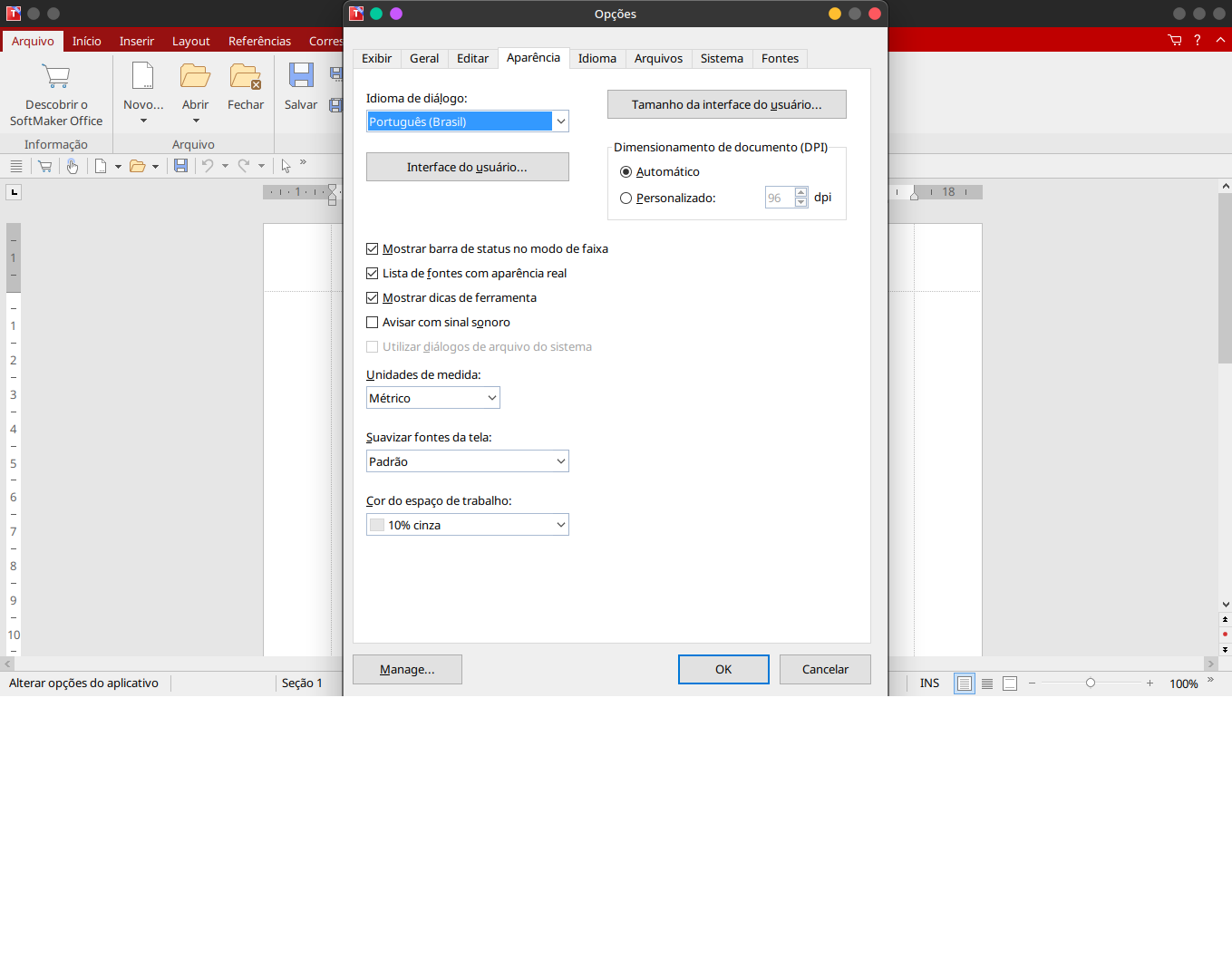

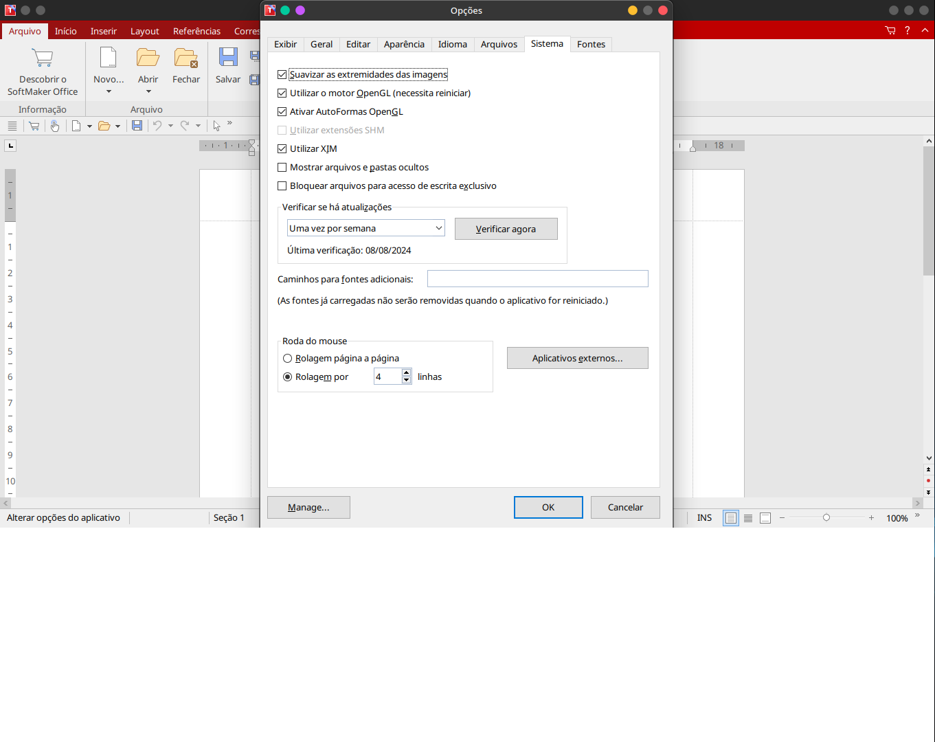

The problem is that there is no option to change it.
In the APPEARANCE tab, as well as in the SYSTEM tab, both within OPTIONS, there is no option to change.
I've attached the screenshots below to help if possible.
Thank you very much for your attention.

Hi, thanks, but there's no option to switch to GTK. The User Interface is just the type of template I want to use. FreeOffice 2021, or even 2024, doesn't have the option to switch to gtk. Unfortunately.
Posts: 719
Re: How to configure FreeOffice's "Save As" to display the Dolphin page
The option is the last check box on the Appearance tab. However, for you it is greyed out, meaning it is unavailable. I only have FreeOffice 2021 in U.S. English. For me, that option is available. I'll have to load up FreeOffice 2024 and see if it has been disabled in the update.
