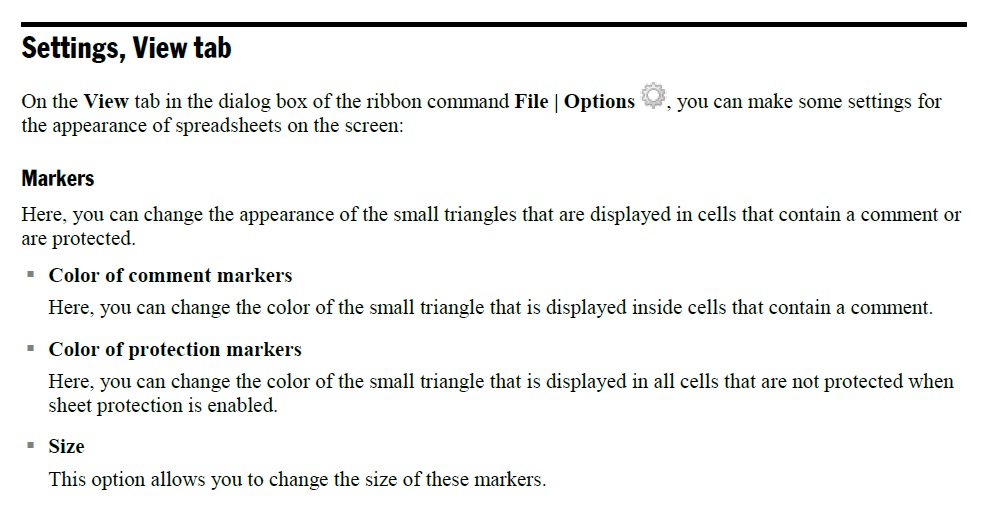

I just created a table using Free Office Plan 2024 and noticed that the cells that are supposed to receive the data, and that are not locked, have a green mark at the bottom left, even when the sheet is protected.
On the 2021 version, this green mark disappeared as soon as the sheet was protected with or without a password. Is this normal?

Re: Green mark
From the User Manual:

Post by Mimile »
Thanks Woody!
