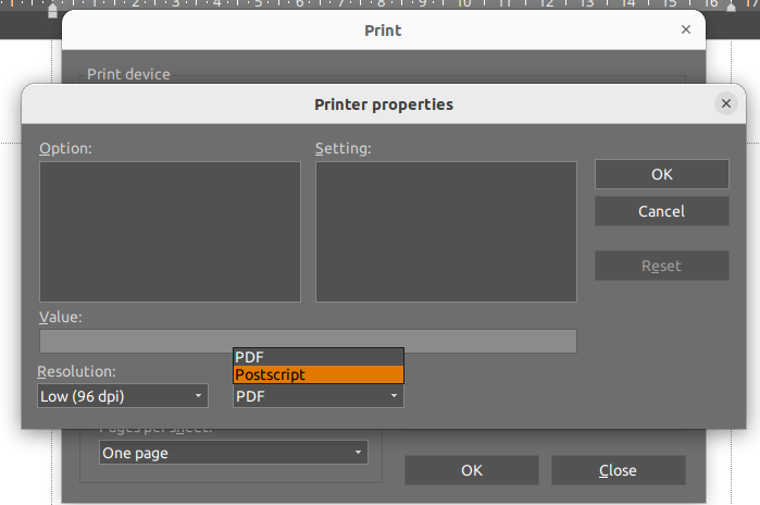

Please select Postscript in the field Output in printer properties dialog box as shown in the screenshot attached.

Selecting Postscript fixed the problem! Many thanks, Wayne
