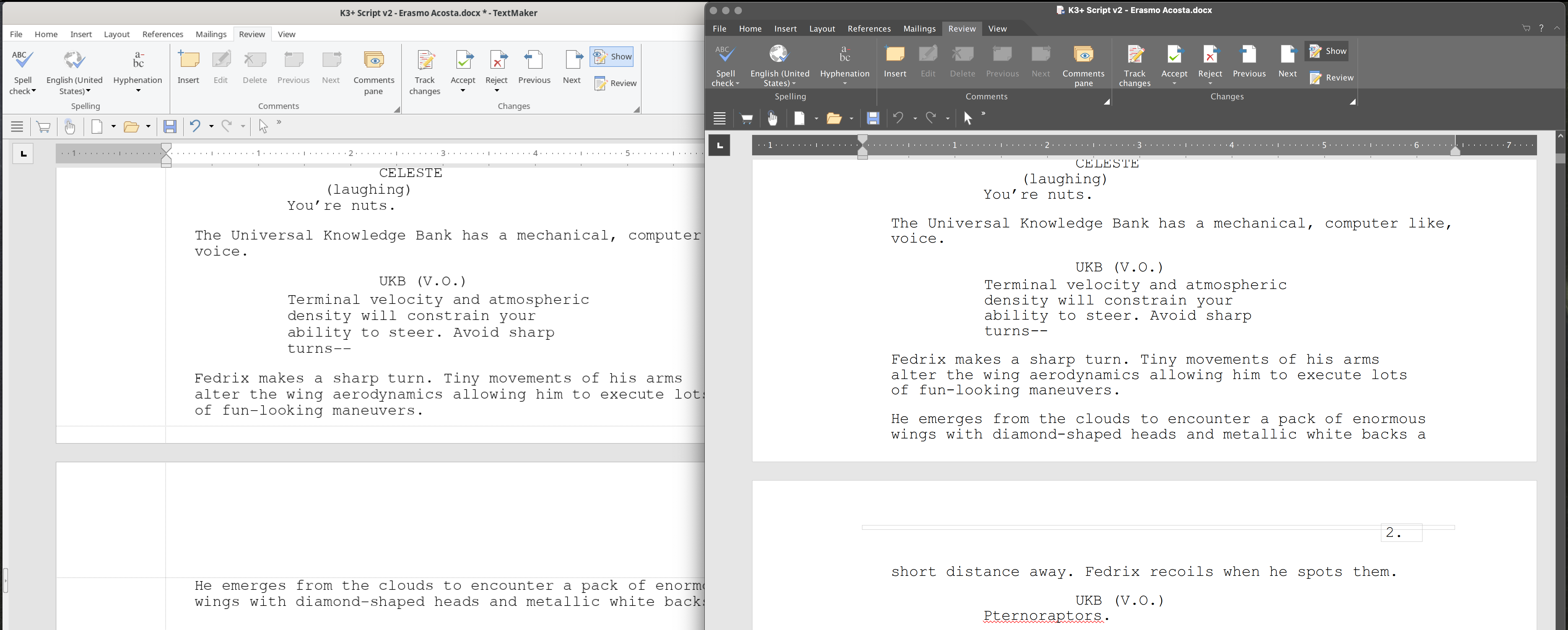

I’m planning to switch to Linux soon and have a document created with TMF for MacOS—it was actually created by converting a pdf to docx using the Adobe website. The issue is that the document doesn’t display properly on Linux. From page one I can see some lines are pushed down to the next page. I’ve also tried TM on my iPad and the document displays correctly, so I believe this is a problem with the Linux version only. Any ideas?

Thank you for posting your problem. It's actually not an issue with the TextMaker for Linux but some fonts and formattings are operating system dependent, that's why it's showing little difference in line spacing in your attached screenshot.

Update: I followed these instructions to install TrueFonts on Fedora:
https://www.fosslinux.com/42406/how-to- ... fedora.htm
Rendering is now perfect, matching TextMakerFree on MacOS, and iPad.
