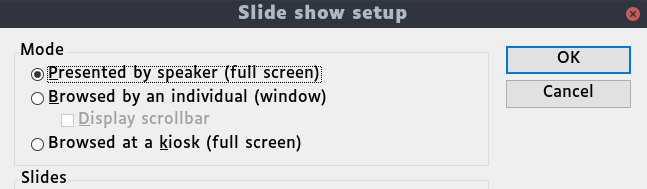

Hi,
I am having an issue with the presenter view. My computer has two displays (the laptop's and a connected monitor) which are recognized by Presentation. I think I have configured presenter view correctly (see attached screenshots) but when I start the slide show, only the slideshow starts, without presenter view. It used to work perfectly before the upgrade to NX.
I tried restarting Presentation, re-plugging the external screen. Note that I tried on another screen and it worked. But on my own screen in my office, it consistently fails.
Can you help me with this?
Thanks!
[EDIT] I can't believe I didn't test this before, but the presenter view activates properly if the Presentation window is on my laptop screen when I start the presentation. If the window is on the connected screen (though the external screen is configured as my primary display) then the presentation view does not start.
Screenshot of the display configuration
Screenshot from 2023-08-22 11-02-00.png (6.71 KiB) Viewed 70293 times
Screenshot of the slide show setup

Thanks for your post, but we are unable to reproduce this problem. As you are also not facing this problem when you are using different screen, there might be some problem with your this screen settings/display driver etc.
Please check the settings, reinstall driver or get help from your IT support staff for this external screen problem.
You can also try manually selecting display instead of selecting Auto.
Please also make sure that you have checked the options "Presenter view" in the display settings.
