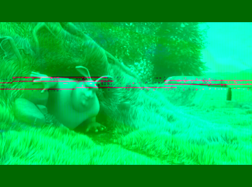

I have also installed the ubuntu-restricted-extras, as you suggested (I don't know how I did install my codecs previously) and I restarted my pc, just in case. Unfortunately, playing the video is still causing the program to crash. Except in some rare cases (I tried multiple times, also with different videos) where the video plays, but appears green and with artifacts, as in the screenshot below.
The same behavior (crashing/green image) happens if I click on the video, Media object->Play media clip
