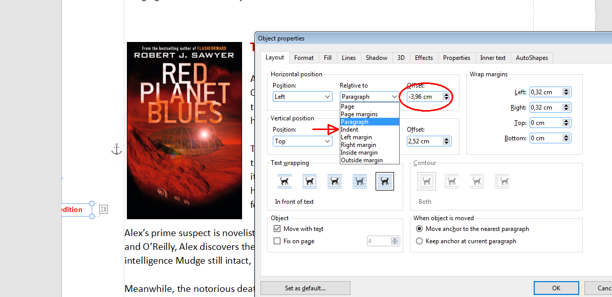

I got a reply from our developers' team:
"The position of both text boxes says 3,56 cm left of the column, and the question is now where the column starts. As the document is a single column, TM assumes the left page margin. Word thinks it's the position where the text starts after it has moved because the image blocks the regular place.
Basically, there are two methods to solve the problem:
#1: Set the position to 'relative to indent', as seen in the screenshot (restore the old offset value)
#2: Don't rely on the Word method of placing two objects independently, but 'group' them so that you have only one object.
(#2 is the better method)" See the screenshot for reference.

My colleague Raitis forgot to tell you that we fixed the issue and the fix will be included in the next beta update.
