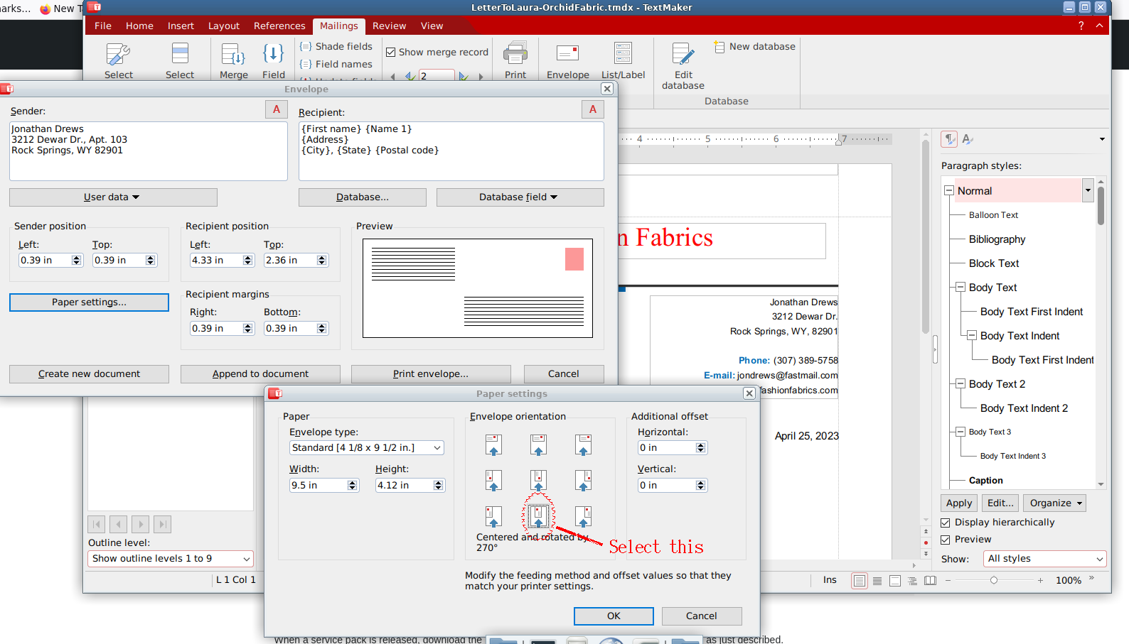

When I print using Mailings -> Envelope the printer continues to print until I turn it off. This does not happen with letter sized paper and an ordinary letter.
The expected behavior is that it should print only one envelope and not keep printing the same envelope over and over again.
If I turn the printer off and then back on, then I can insert a new blank envelope without it immediately printing.

Yes I am using the regular print function. It's this one: The reason I am sure it's a printer problem is I used Mailings -> Envelope but left one letter sized paper in the tray. It printed one "envelope" on the letter sized paper and stopped. It worked as it should. So it appears to be the printer is looking for a 11 inch long piece of paper and is instead being fed a 9.5 inch long envelope. That is just a guess on my part. I also think part of the problem is that my Linux distribution, Devuan, has a printer configuration tool that won't allow me to use the supplied *ppd that came with my printer. This tool insists on configuring the printer. Normally, I configure the printer through cups using https://localhost:631. The printer setup tool overrides my CUPS configuration and instantiates its own version. That version idoes not use a *.ppd file.
