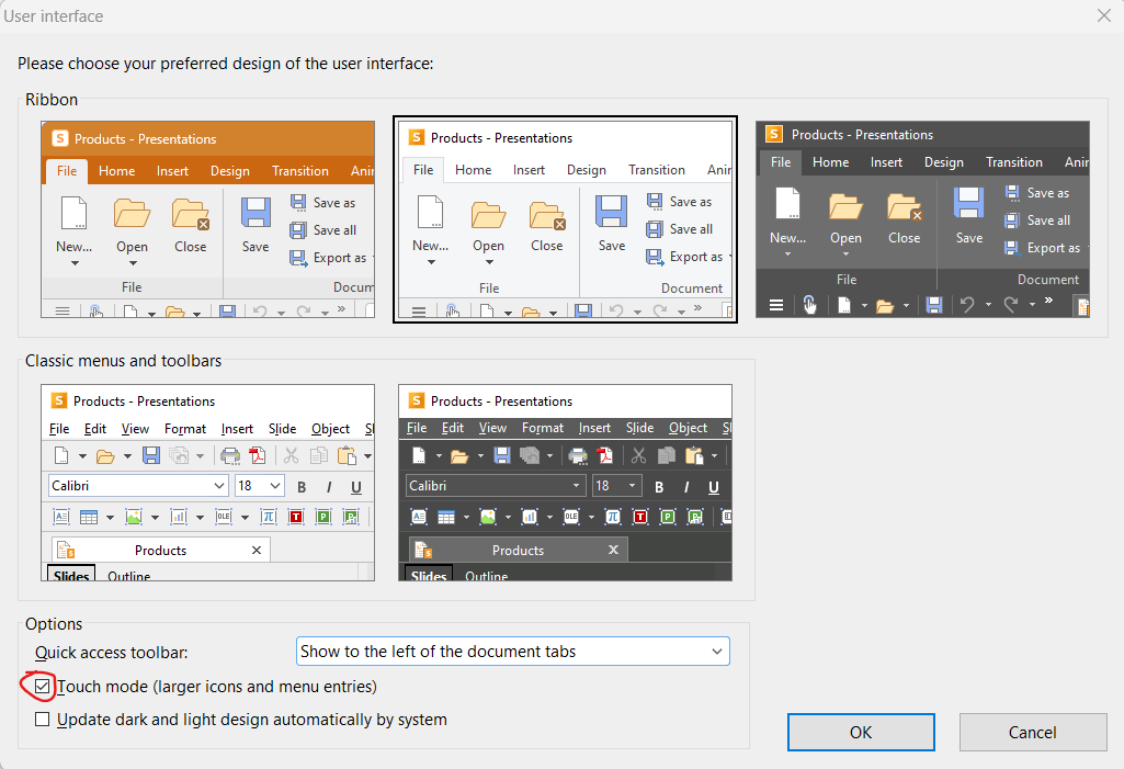

Did you use the function shown in the screenshot?

Thanks so much for replying with a solution. I hadn't clicked on that option for 2 reasons. First is that I didn't know it was there. I have the laptop system setting on 125% but the ease of access font setting is on 180% which helps me read the SoftMaker tab wording. As a result of those 2 settings the User Interface options box doesn't fully display on my screen, it cuts off just after the 'Quick access toolbar' option without me realising there was anything below that. After reading your message I temporarily set both the ease of access and system to 100%, the User Interface box was displayed in full and I could see the option you highlighted. However, without your prompt, the second reason I wouldn't have clicked on that option is I don't have a touch screen laptop and I would have assumed this option was just for touch screen devices. Would it help to change that 'Touch mode' wording so people like me know it isn't only for touch screens?
Having now seen that second option, and with your suggestion it might help, I ticked it and it has made a huge difference. I can now see what the icons represent and the icons work even though my laptop is not touch screen. Thank you very much for your suggestion.

I apologize for the misleading user interface in the screenshot (it wasn't intentional). My main idea was to make your attention to the option "Touch mode" which is useful not only for touchscreen devices but also when you need larger controls.

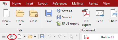

I also find the wording "Touch mode" irritating, assuming that it enlarges the icons.
But the original idea is: Touch Mode changes the spacing of the buttons to accommodate using a touch screen.
In practice, most users will use this option to enlarge the icons, as it is well suited for this purpose.
By the way: You can enable/disable Touch mode more quickly on the Quick Access Toolbar.

There is also an option on File...Options....Appearance. Select check box on Prefer using larger controls. However once this option is checked, you have to restart Textmaker to apply it or if you have set it and turn it off, again you have to restart.
Once you have selected Prefer using larger controls, you can toggle these enlarged ones larger still by clicking on the Touch mode symbol on the Quickstart ribbon
