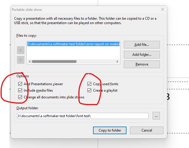

When I give my teaching sessions, I send the PowerPoint presentation to the group hosting the session or take it with me on a thumbdrive. I embed the fonts. The presentation goes as a distinct unit WITHOUT additional files. It runs as a show. It does NOT build the presentation as it is being shown from the composition blocks.

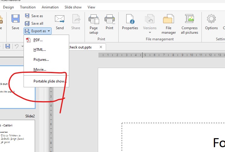

When I exported my test presentation, the set of folders was enormous; it contained all kinds of additional documents; it wanted to make alterations to the registry of the computer hosting it.
Conclusion is simple. Not suitable for purpose.

is the presentation as saved by the app
Can't get this forum to save more than 3 attachments so the layout will be in next post
Chose the output method
you get these set of responses in the default
if you leave it on default the output set folder is immense

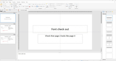

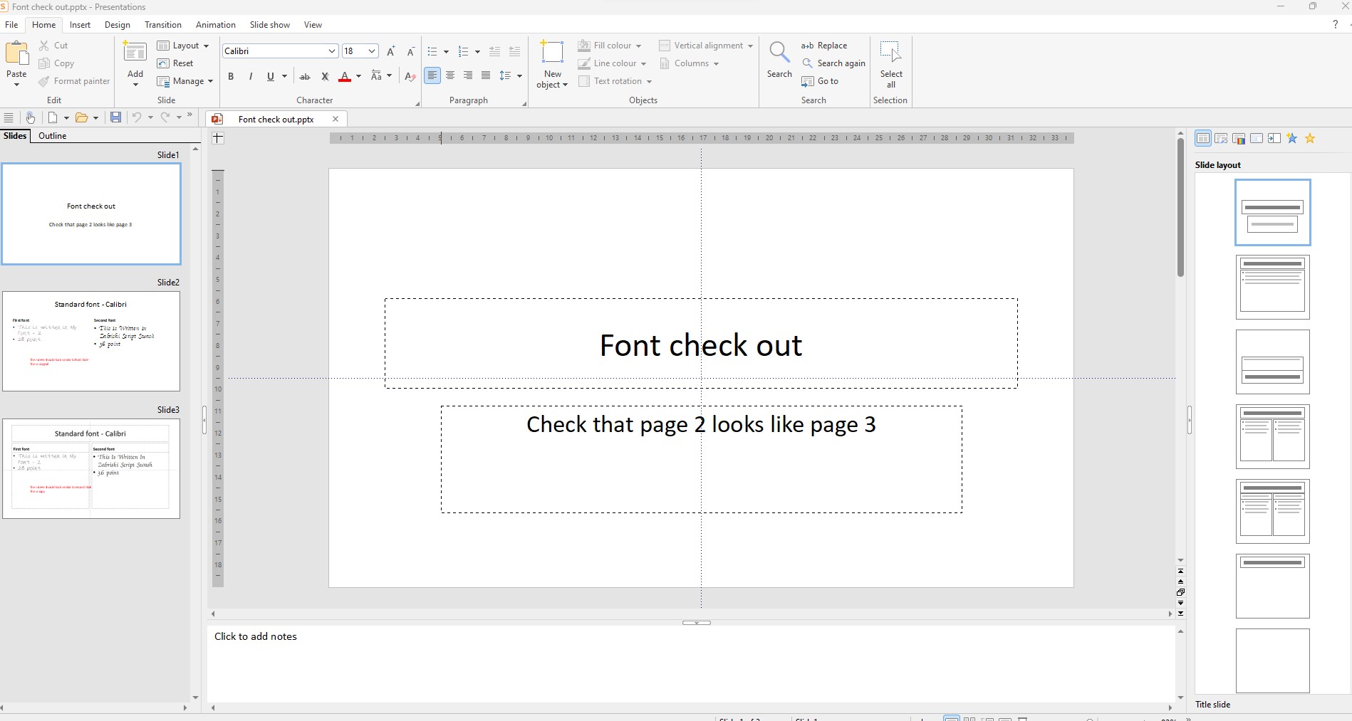

the screen layout should look like this
Is the font retained in the presentation when shown on a remote machine?

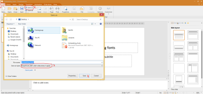

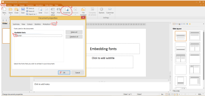

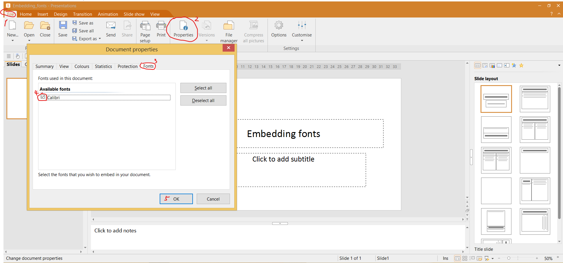

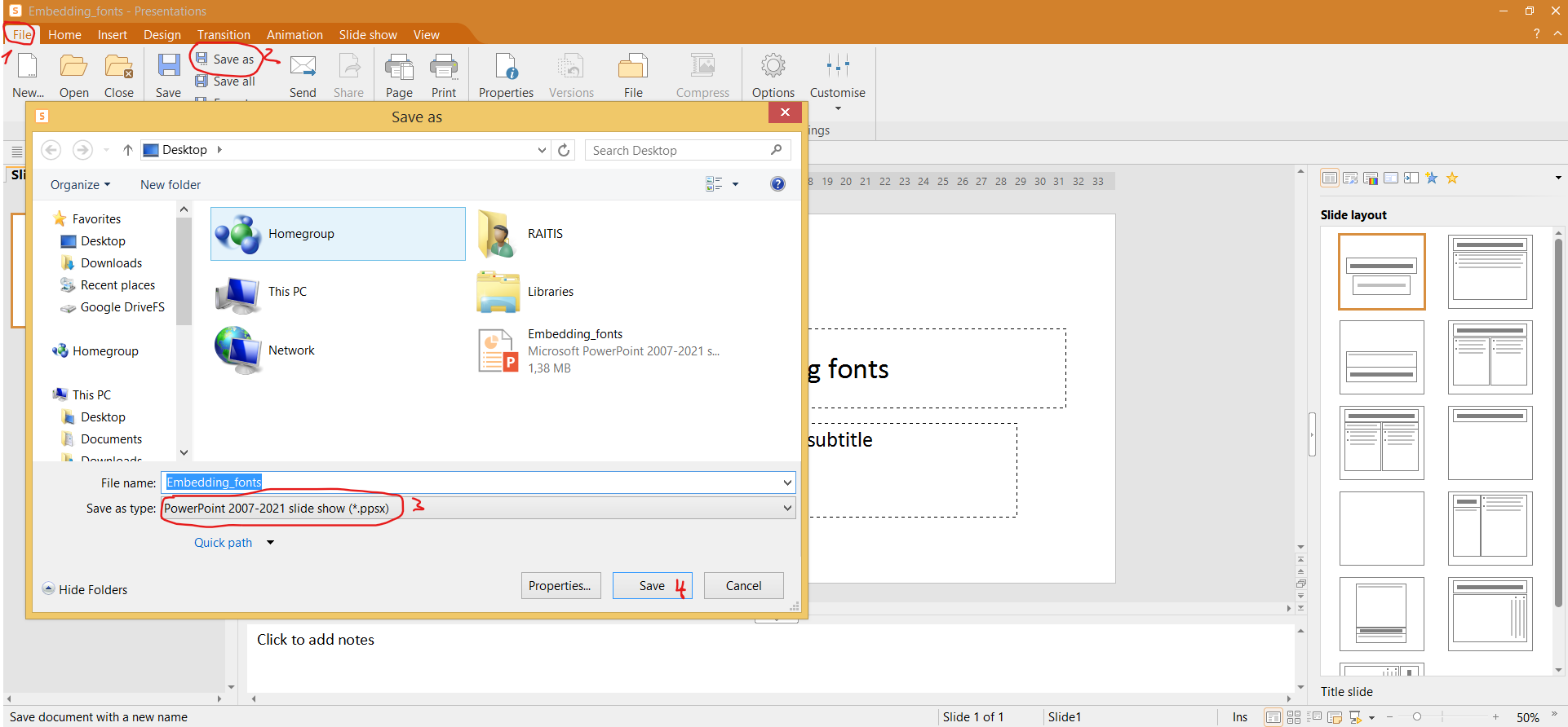

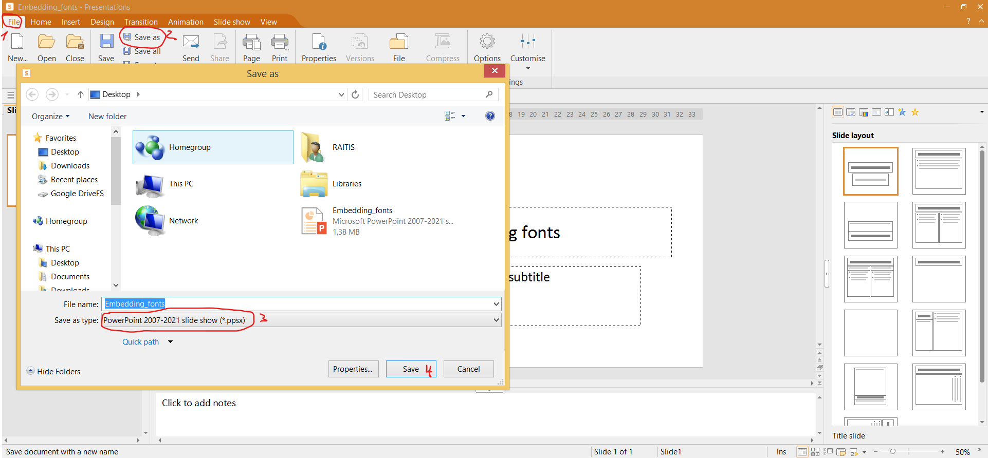

Ok, we did understand what you do and how it should be done.
To test embedding of fonts you don't have to use export to Portable slide show...
This is to be intended for the case when you have no other presentation application on your computer. (It is why so many folders are included, which include a "minimal" version of Presentations, this is intended for a computer that has no presentations program available.)
To test embedding of fonts you should proceed as shown in the screenshots. You save the presentation in PowerPoint 2007-2021 slide show (*.ppsx) format that is supported on almost any modern presentation program. You have to embed fonts in that presentation file. Invoke File>Properties... select tab Fonts and mark all fonts to be embedded.
To test if embedding fonts really works, you can temporarily remove (uninstall) the font that was embedded (making its backup).
If you want to play a presentation without any presentation program on the target computer then you should export it to Movie... format.

Thanks.
I'll try the font removal experiment.
el48tel
Posts: 31
Joined: Mon Dec 08, 2014 3:43 pm
Re: Presentations with embedded fonts
Post by el48tel »
update ---- this does work
