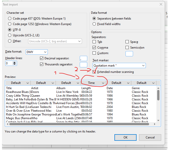

The latest beta (S1110) offers you now 2 possibilities that work:
1. Select a type in the import dialog for length (like "Time").
or
2. Use "Extended number scan", this checks if a certain type is used in a column.
Hook

miguel-c wrote: Mon May 15, 2023 7:40 pm The latest beta (S1110) offers you now 2 possibilities that work:
or
Well, sort of. What either of these methods do is make it so what I used to do—select the column, right click, select cell..., custom and specify "m:ss" and ok—still works as it used to. So what you have done is added a extra step in the import dialog, I mean, it'll work now that I know I have to do that extra step. But why? Why the extra step?

The initial reported problem was that the custom time format wasn't applied and for that reason, our developers' team fixed it.
I don't think it is an additional step, you selected the field data type anyway. PlanMaker can't remove simply leading zeros, it can't guess if users don't need them in this case.

I got a reply from our developers' team.
Previously during import PlanMaker ignored the text separator. That's why we changed it (implemented these additional options or steps to be done before importing data) and added the extended date scan.
Remember, the file encloses all data in ", this usually means everything is text, not date.
