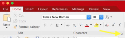

Edit 2: Here are a couple of screenshots:
Click on the small triangle where my arrow is pointing.

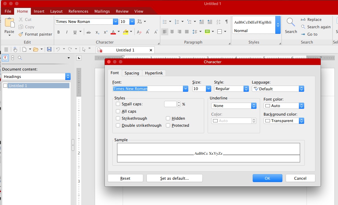

This is the dialog box mentioned in step 2 above
