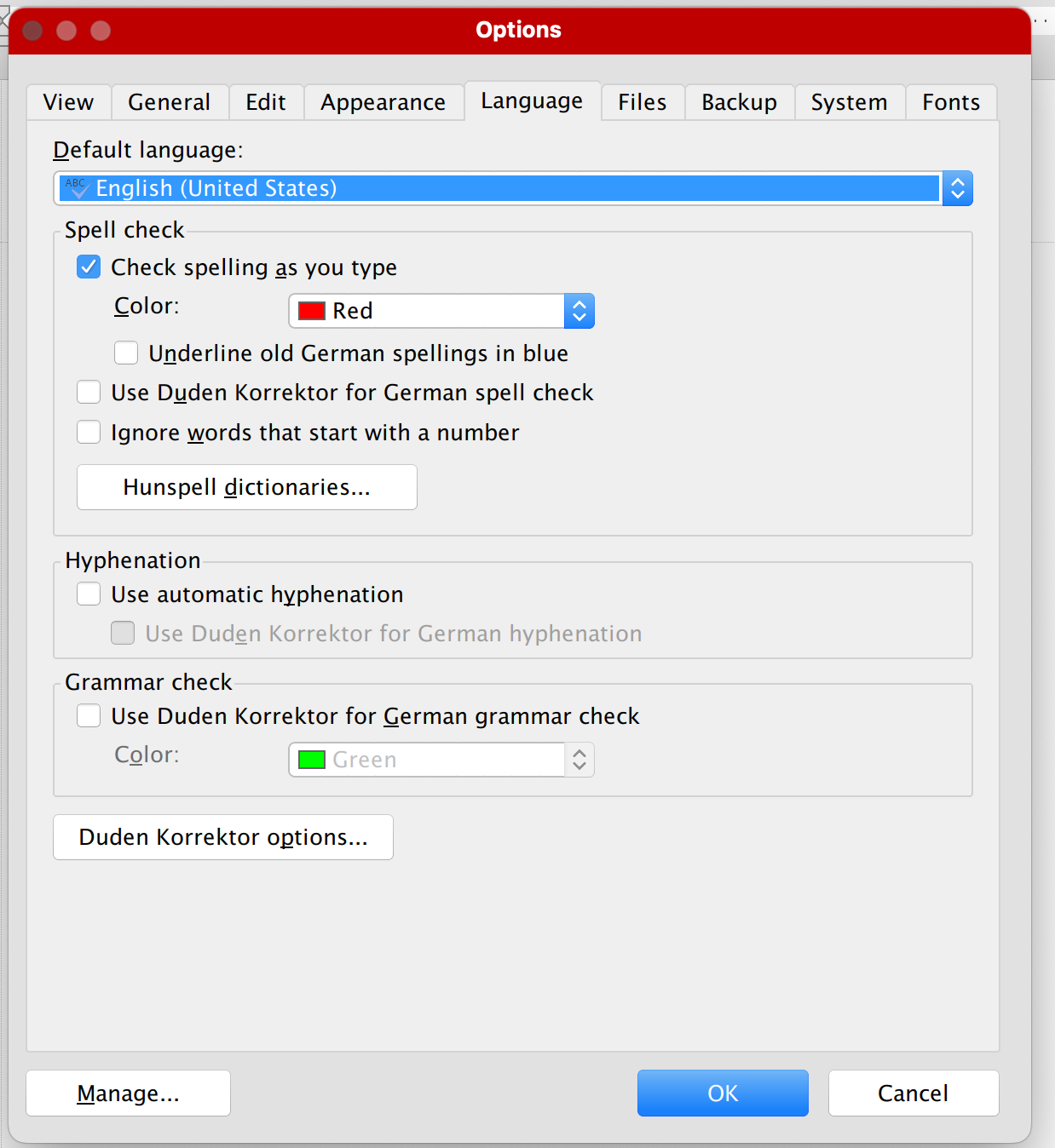

In TextMaker>Preferences(Options)>Language do you have "Use automatic hyphenation" checked?

"do you have 'Use automatic hyphenation' checked?"
No.
See attached PNG.

Either the praragraph format or the option Tools > Automatic hyphenation (which applies to the document currently open) may override the global option "Use automatic hyphenation".
So you should first check if Tools > Automatic hyphenation is turned off and then check the paragraph style "Normal" in the right sidebar (select "Normal", go to "Edit...", tab "Text flow", and set "Hyphenation" to "None").
If you want all your future documents without hyphenation, open the document template "Normal.tmvx" (choose File Type "Templates (*.tmvx, *.tmv)" in the "Open" dialog), change the paragraph style "Normal" there and save the template again.
