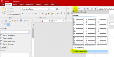

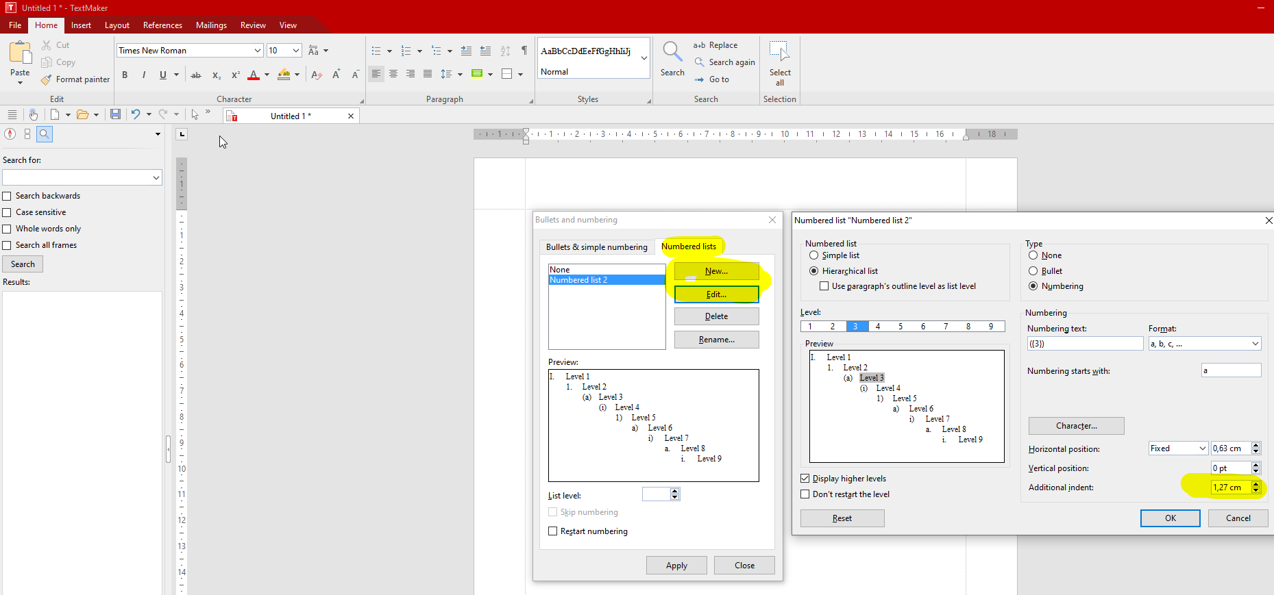

Hi, have you looked into format numbering? Its as per screenshot below:
Then go to numbered lists and add a sample one that suits your needs.Then you can edit it to see how its structured and defined. You need enough levels of the list defined, along with style and indent.
It work as expected after indenting using TAB.

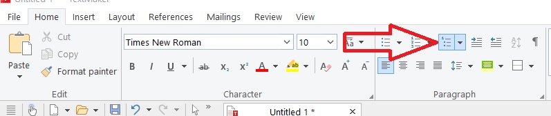

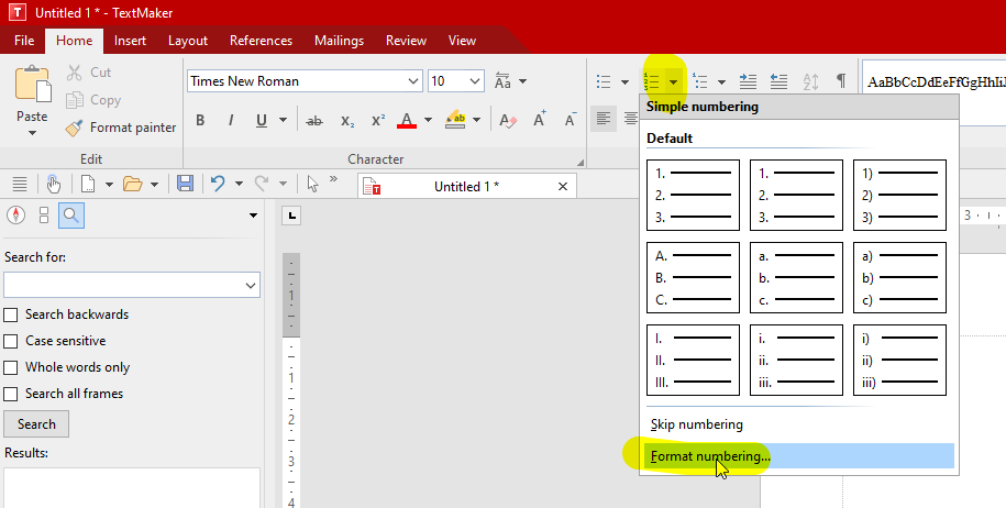

Posts: 3543
Re: Bullet Point issues
Thanks for your post. As per your first post, your task is achievable with numbered list and not with simple numbering. Numbered list is next to simple numbering, as shown in the below screenshot. Please use it.
