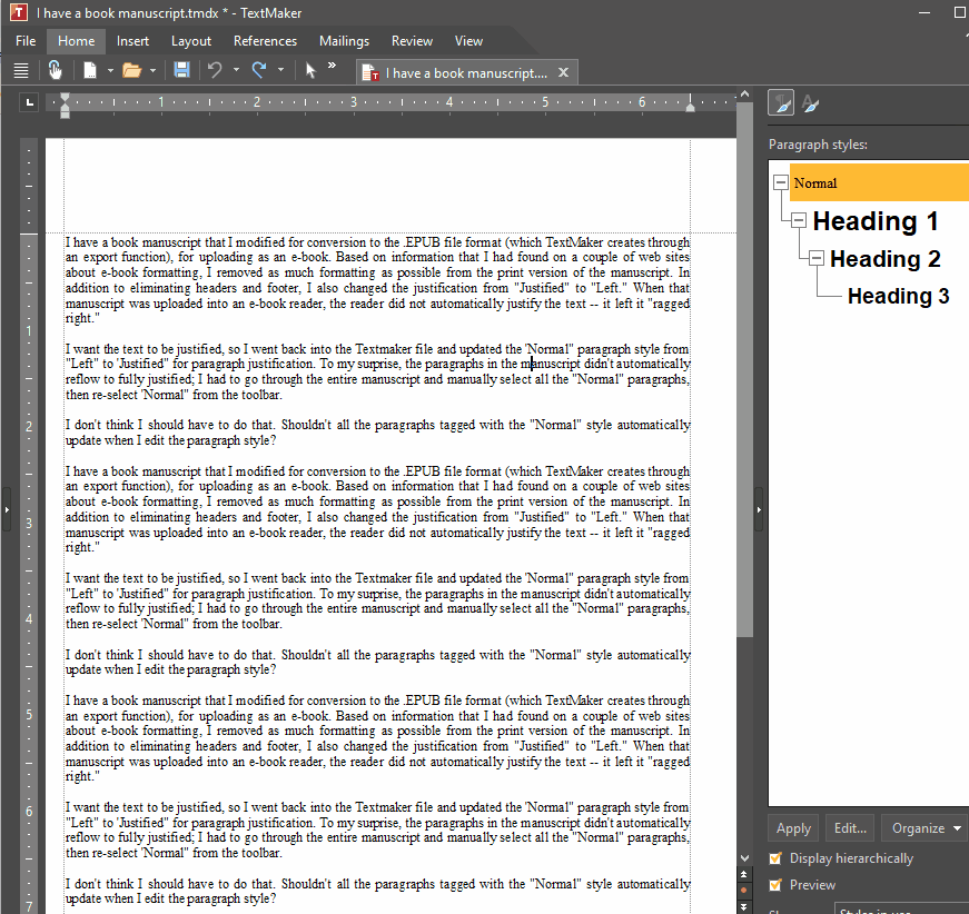

Thanks for your post, but we are unable to reproduce this problem as changing alignment is updating in all the paragraphs on which that style is applied.
To demonstrate this, please refer to the below screen recording:
If you are facing this problem with any specific document, please forward it to forum[at]softmaker.de so that we can analyze it.
