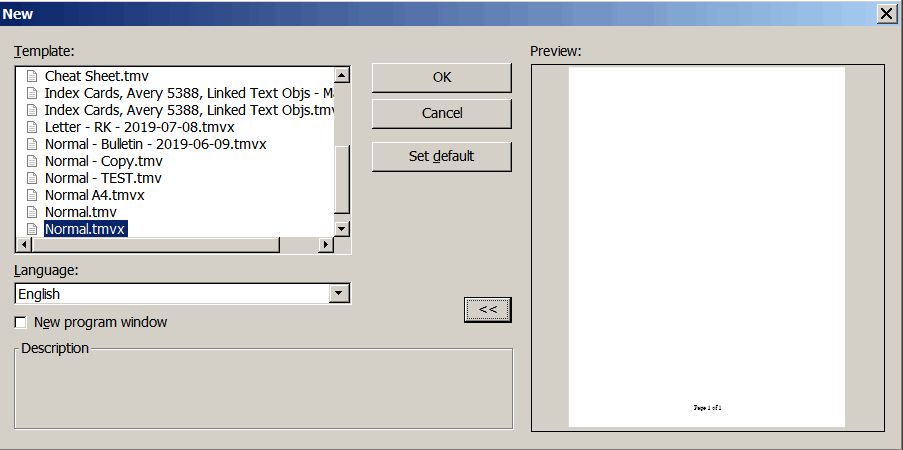

Whilst one can modify the new new-dialog-box, one can't modify it to my requirements. What I like is to be able to easily read the template titles, which I always make descriptive (to me, at least, mostly ;-)). Being able/forced to scroll though a sequence of images of blank pages just isn't ideal for my workflow nor does it seem like an improvement. IMHO, TM's dialog used to be better, even as recently as TM 2018:
TextMaker Pro 2018 - File Dialog with Preview.png (9.37 KiB) Viewed 41174 times
