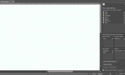

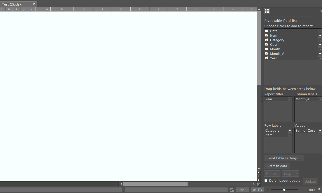

Thanks for sharing the sample file, but I am unable to reproduce this problem as I changed the format of the pivot data to number format without decimal, added new data in data sheet and then refreshed the pivot table, and it retained the set format without any undesired changes.
To achieve this, please follow these steps:
1. Click on the pivot table.
2. Now in the sidebar, Values items, click on the down arrow of item "Sum of cost".
3. Select the last option, "Value settings".
4. Click on the tab "Show values as" and then button "Number format".
5. Now from this "Number format" dialog box select number and make "Decimal places" zero.
6. To save this setting, click on OK twice.
After this you can add new values in the data sheet and the pivot settings will not change on refreshing the data.
I have attached here the screen recording of these steps for your reference, without any display of your confidential data. I am also sending you the updated file in your email, please check it. Please feel free to contact us for any further assistance.
