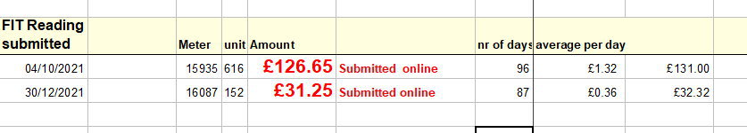

Snap_Saturday, 8 January 2022_16h29m47s_002_FIT calculations.pmd - PlanMaker.jpg
The amount due is calculate with E47 =(D47*(17.87/100))+((D47/2)*(5.38/100))
Values are taken from tariff worksheet and hand-entered

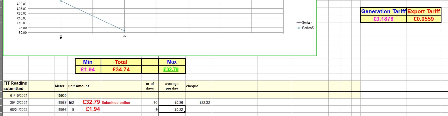

I have just added the formula so that you can get the latest tariff values in graph sheet as per your requirements. No other change.
Here are the values I am getting after adding your latest tariff values.
