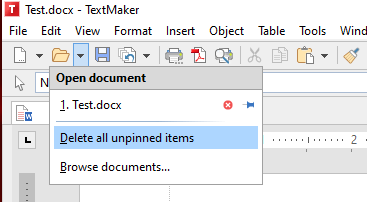

Is there any likelyhood that a "Delete all unpinned items" entry might be added to the standard "File" menu in the future to avoid having to change the interface in order to access it?
Posts: 3790
Re: How to clear "Recent Files" list?
Thanks for your suggestion, but it's already there in Classic Menu and toolbar interface also on the same place. Please check the attached screenshot.
Clear recent unpinned.png (9.42 KiB) Viewed 28023 times

Ah - my bad - I didn't connect the terminology "unpinned items" with "recent files". Apologies.
