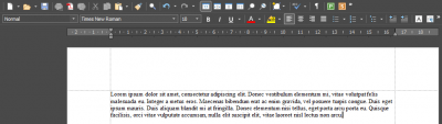

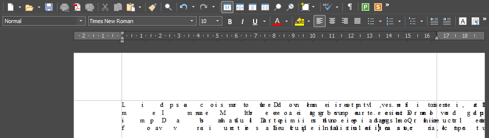

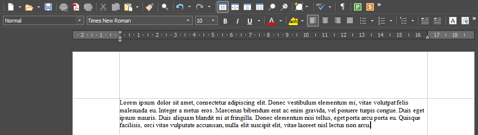

In TextMaker, when I open documents one by one, everything is fine. When I open two or more documents and switch back to the first tab, I get scrambled text.
I'm still using Windows 7 X64.
Please see attached screenshots.
