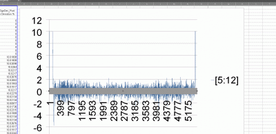

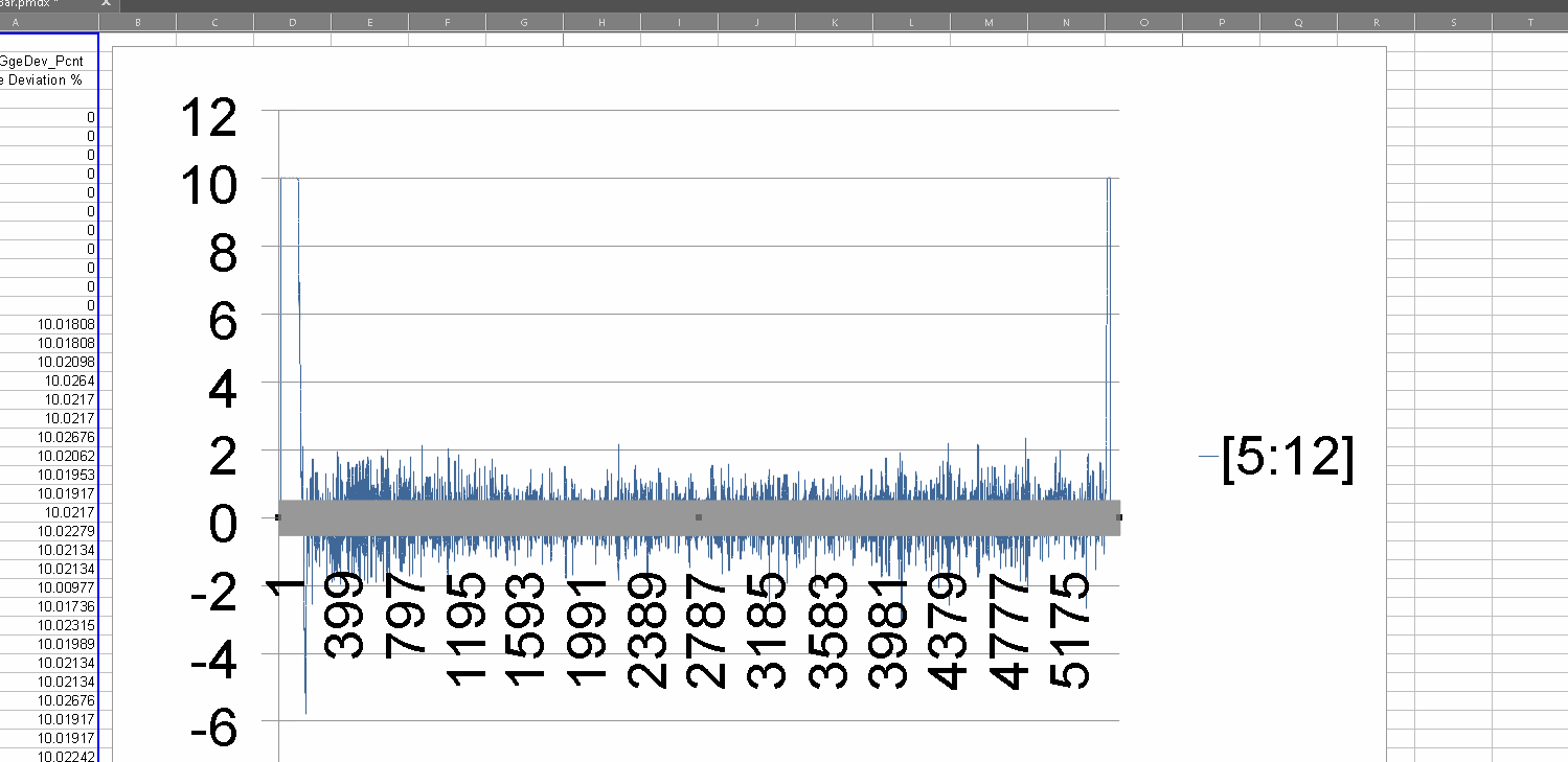

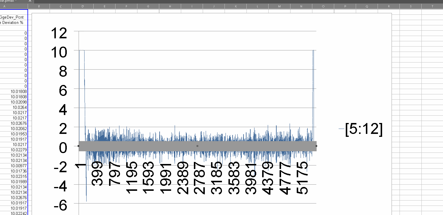

When I open a CSV file, and select a single column of data then plot that as a line graph I get a grey bar along the X axis. Photo enclosed.
What is this, and how do I get rid of it? Clicking on the data brings the datapoints to the front, but the grey bar obscures the axis.

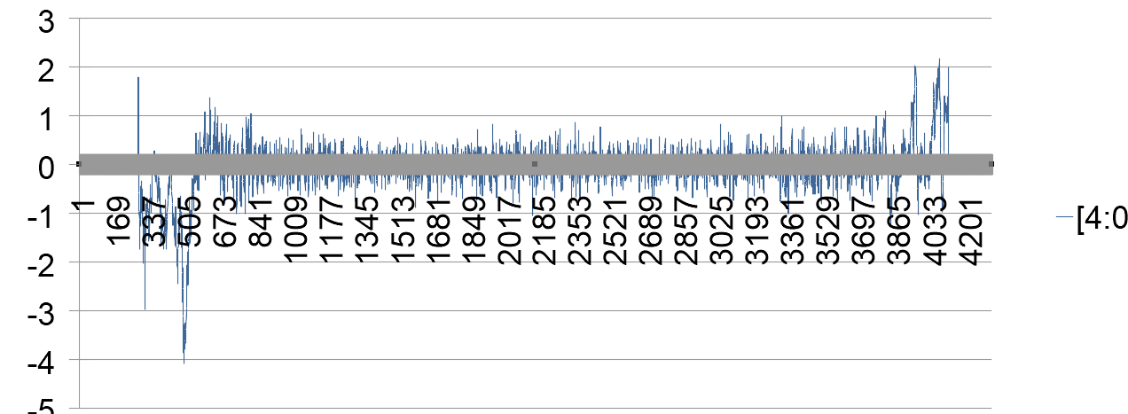

Re: Strange grey bar on line graph
I just did. Open the CSV file that was with my previous post. Select the first column. Insert a basic line graph. Look at the X axis.
You will see the grey area. I have tried this on lot's of CSV files and the effect is the same. The file I attached is nothing special.

Thanks for sharing the file. I have checked it and found it is an axis line. To remove it double-click on X-axis numbers > In format tab under Line select None > Click OK and this line will disappear. Please refer to attached screen recording for better understanding.

It seems to be caused by the number of ticks on the X axis. If you only have a few points on the X axis, you can see all the ticks. As you get more and more points, the ticks all merge into one. There should be a way to reduce the number of ticks as the points increase, or a manual facility to be able to have something like "tick every" so you can still have some ticks, but not a tick every point.
