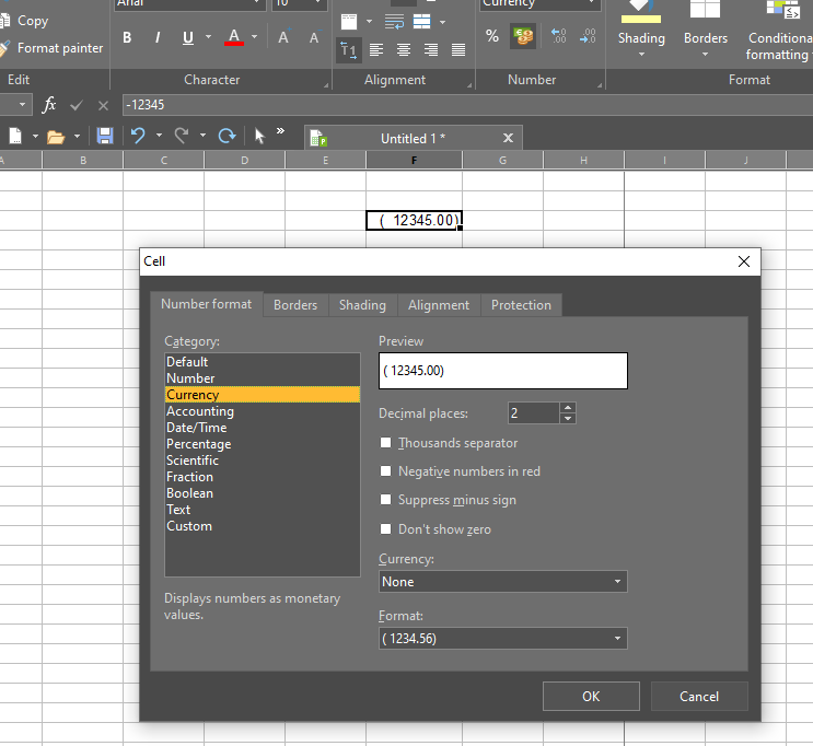

Thanks for sharing these files. If you are looking for currency, we already have this in currency section and if you don't want currency symbol there you can disable that also. Please check attached screenshot and confirm.
