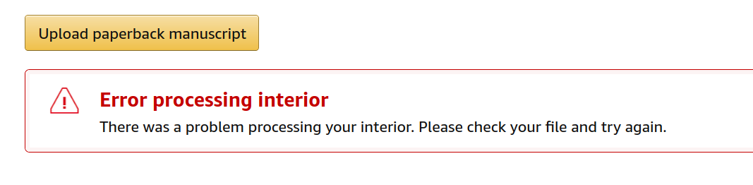

I used TextMaker to typeset my manuscript. I used a *.tmdx file while doing the work. Then I exported the file as a standard PDF and uploaded that file to Amazon. After taking a really long time to process the file, Amazon rejects it with a message that says it ran into an error processing the manuscript. Is there a way to fix this? Has anyone else run into this problem?

Here is the error message:

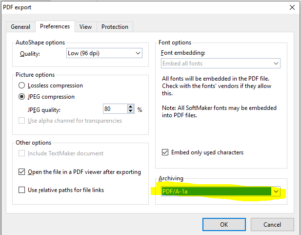

While exporting the PDF please select PDF/A-1a in archiving on the PDF export dialog box as shown in this screenshot. Alternatively, instead of PDF Export, you can also try to print the file to PDF using any PDF printer like Windows default Microsoft print to PDF or FlexiPDF printer, etc.

I tried exporting to the PDF/A-1a format already. Didn't work. I just used TextMaker's print to file feature to create a new PDF and that was rejected as well. Clearly TextMaker is doing something to the file that makes it unacceptable. Correcting that is what I'm hoping you will be able to do.
