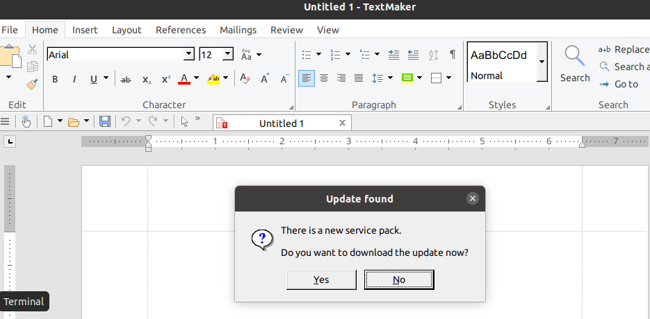

Thanks for the detailed reporting. It seems you have not added the SoftMaker repository. To add SoftMaker repository please run following command:
Code: Select all
sudo /usr/share/office2021/add_apt_repo.sh
Source : https://www.softmaker.com/en/tips-linux
After this, all your commands will work fine and will update the SoftMaker Office as you can see in the attached log file.
'?' > Check for update will always work without adding SoftMaker repository as you can see in the attached screenshot.
Ubuntu log.txt
(2.69 KiB) Downloaded 4347 times
