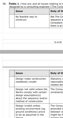

In a table, I have tries to number the cells in column 1, using the Simple Numbering drop-down tool in the Formatting toolbar.

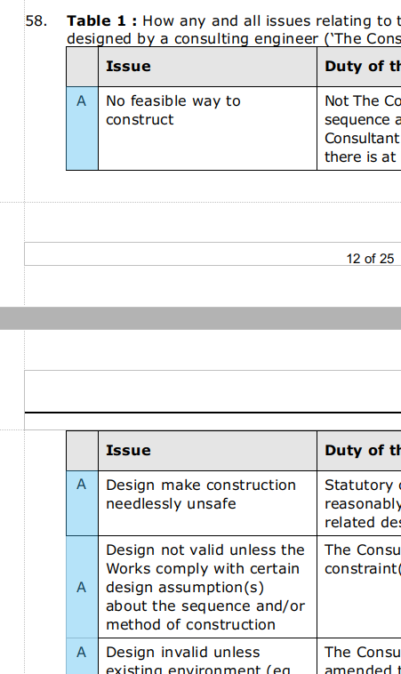

If I select the cells in column 1 and select numbering option A,B,C... as above, this numbers all the cells as A, A, A, A...
I managed to fix this using a work-around.

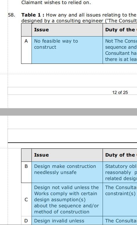

What I did was to select ALL the cells, and number them A,B,C,... as above.
I then selected all cells in columns 2 and 3 only, and used the drop-town tool to select 'Skip numbering'.
This gave me cell numbering in column 1 as A, B, C, D...
All now as I wanted.

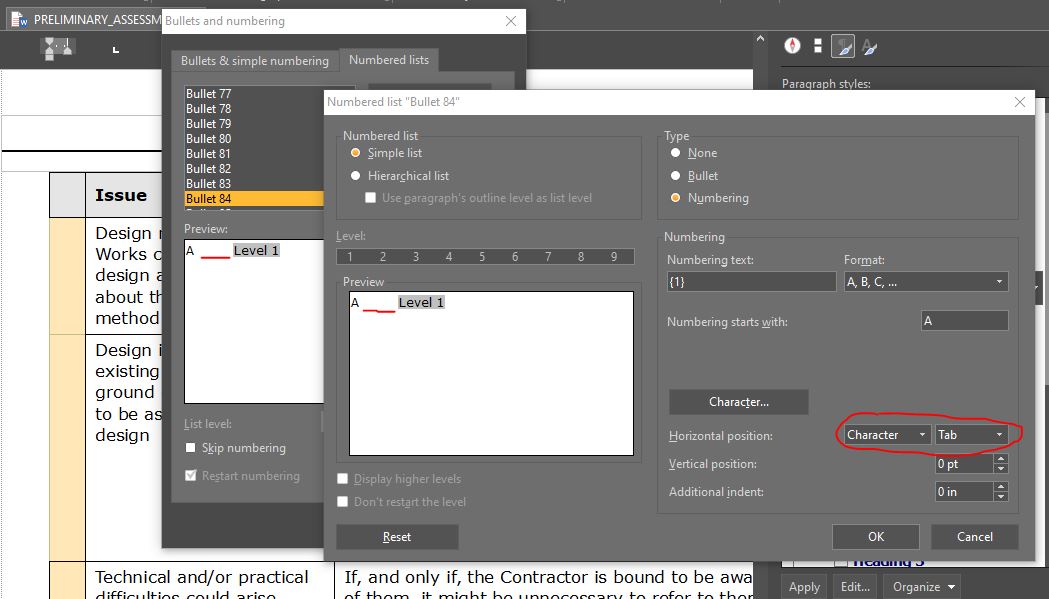

Thanks for sharing the document and the screenshots. For numbering in the table please use the Numbered list instead of simple numbering and you will not get this First problem.
Second problem: Number list is already there in your file but the setting in the horizontal position is changed, please correct it to Character None from Character Tab and save your document.
