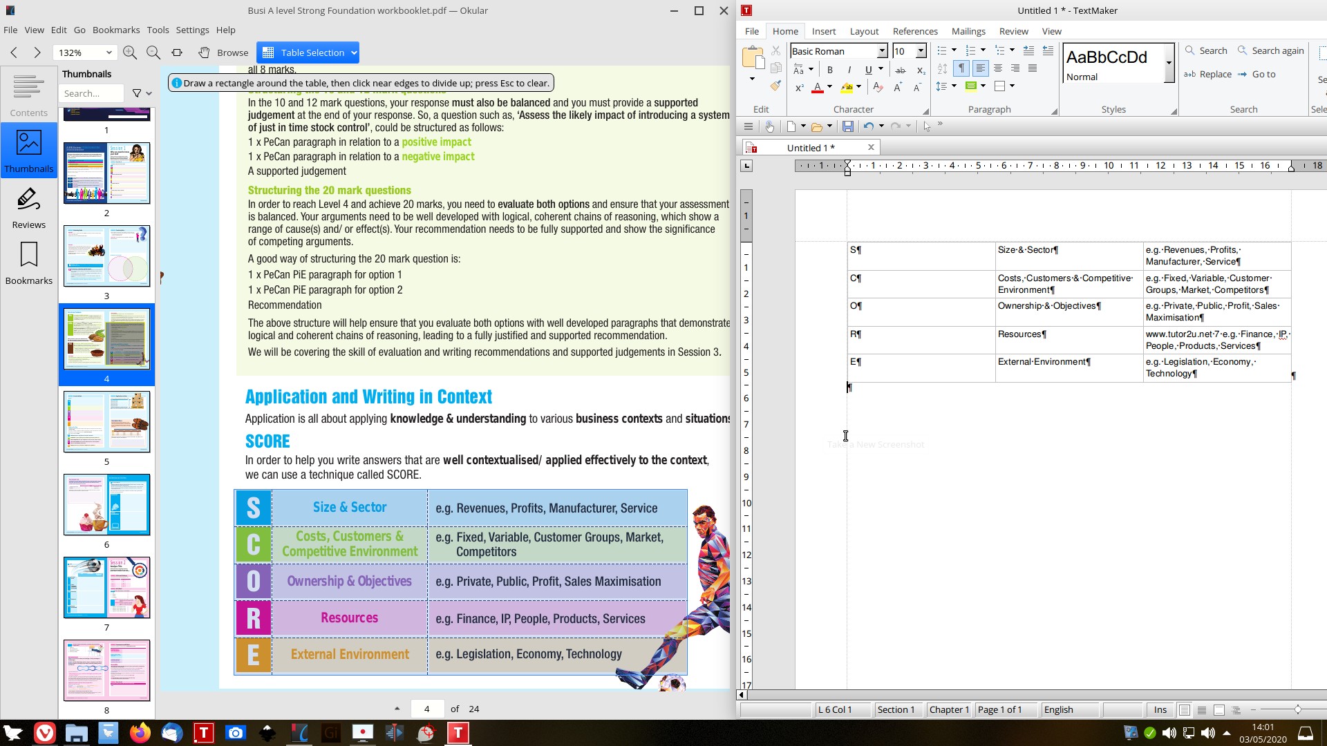

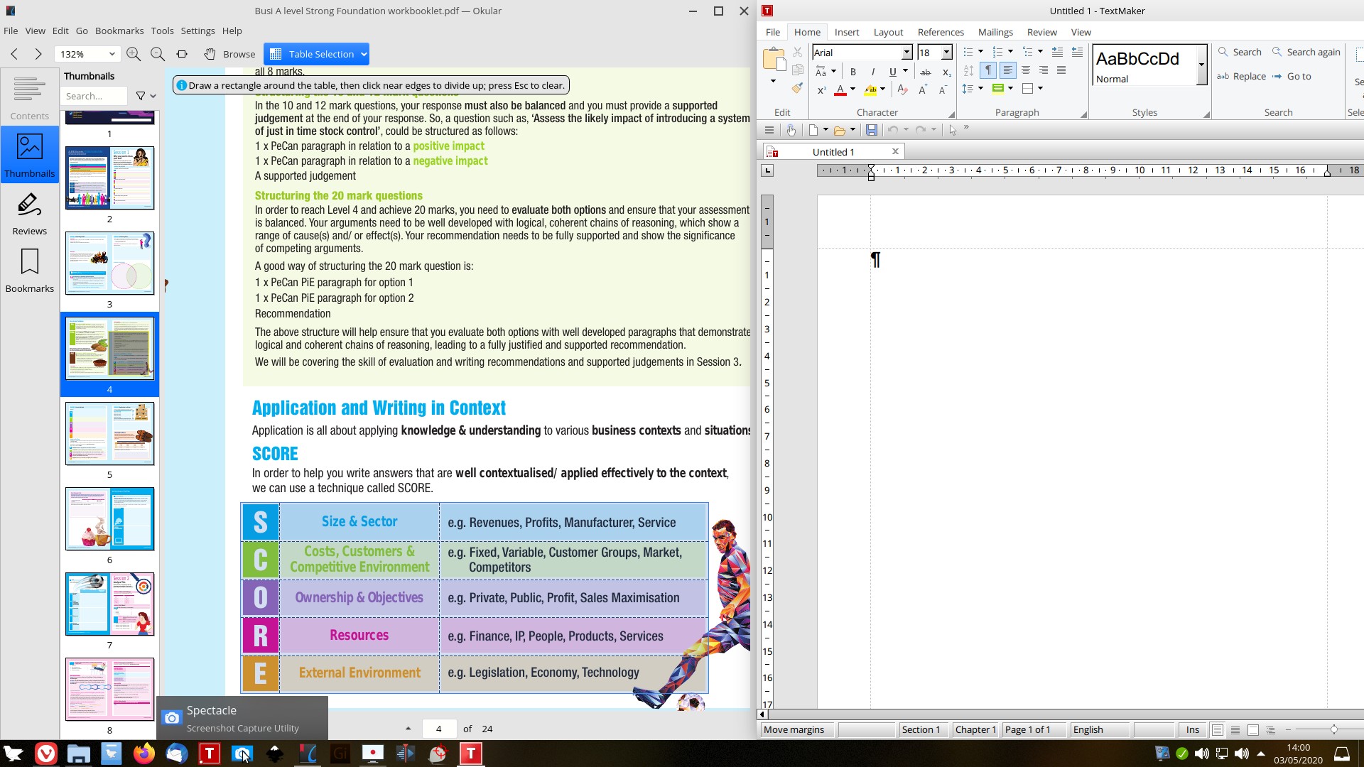

Hi, I am using Okular to copy and paste text and tables into Text Maker 2018. I have changed the default Template to use Arial which is a requirement of work preparation of Modified Large Print documents for work. When I copy and paste tables, the content of the tables font changes to basic roman and not Arial. Thanks.

The Control and space worked. However I would like to know how to remove basic roman completely as I am never going to require it. Thanks.
Re: Any way to remove basic roman font?
Format > Standard (CTRL+Space) resets the formatting to the underlying paragraph format that you specified.
The roman is coming from the PDF itself
Or maybe the font from the PDF isn't available on the system, so TextMaker replaces it with roman.
