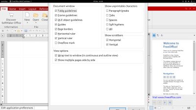

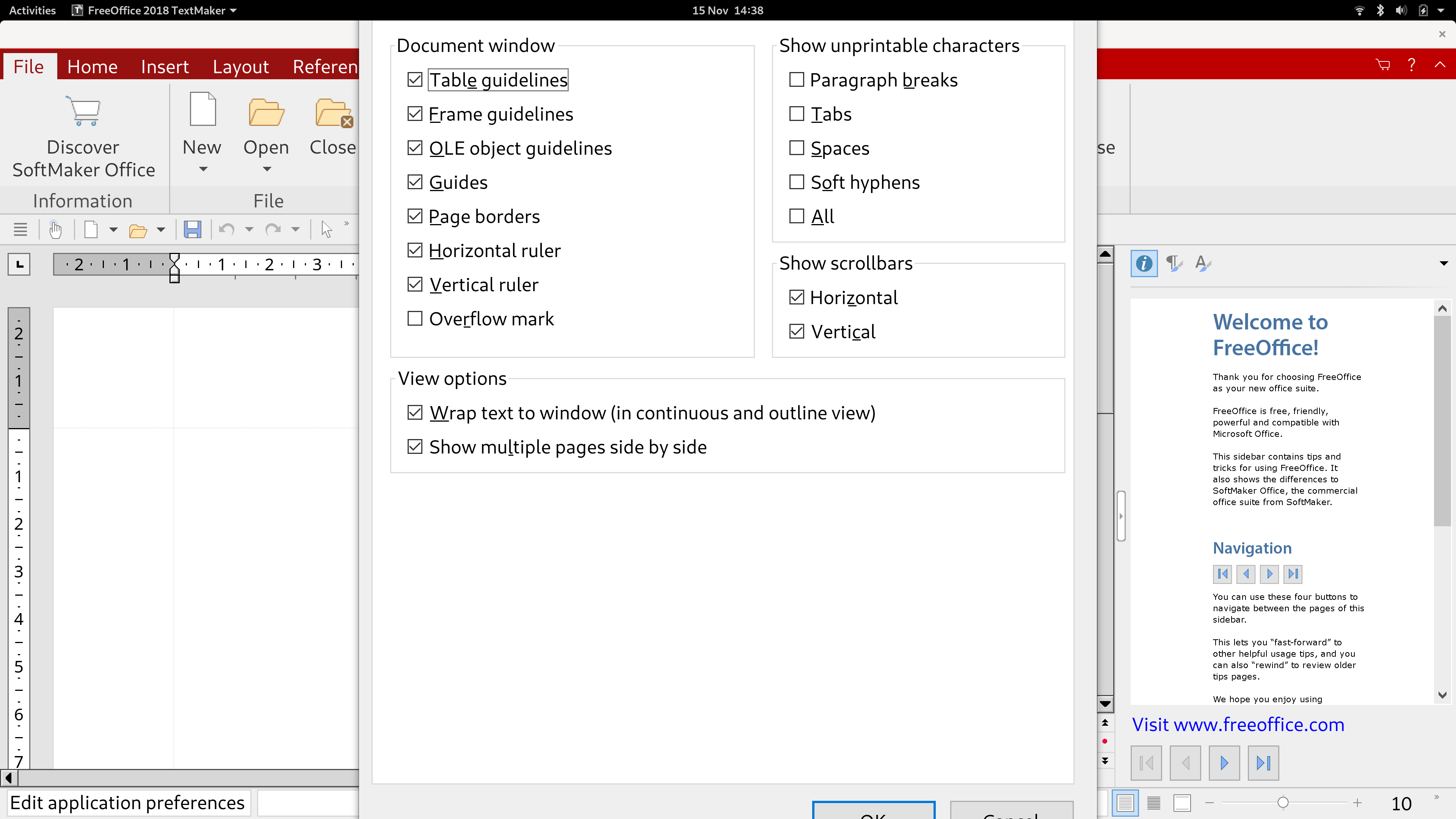

Hi I'm running FreeOffice on Fedora 30 on a Lenovo ThinkPad Yoga with a 4K screen. For whatever reason I now have really large interface text and the option to change the UI scaling is now no longer reachable from the File > Options dialog because it falls of the top of the screen (see screenshot attached
Can I change this in some other way?
Thanks,
Serge

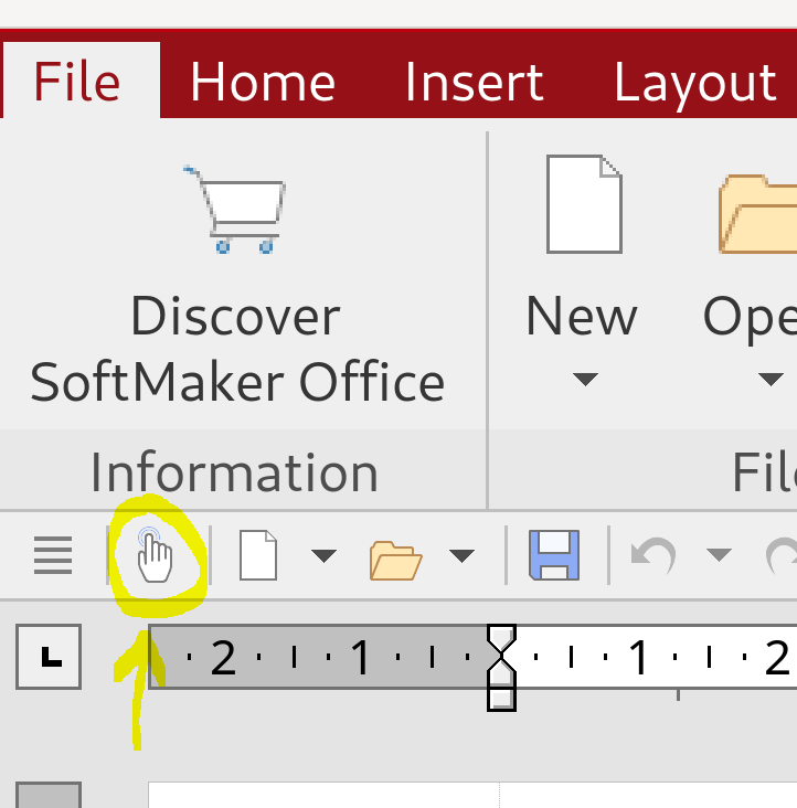

Please try:
1.
or
2. File | Options | Appearance | User interface | Touch mode

When you get to the options dialog that is being cropped:
1. Press CTRL+TAB (3 times) to switch to the appearance tab
2. Press TAB (3 times) to select the "User Interface Size"
3. Press enter
4. Change the control size to normal
