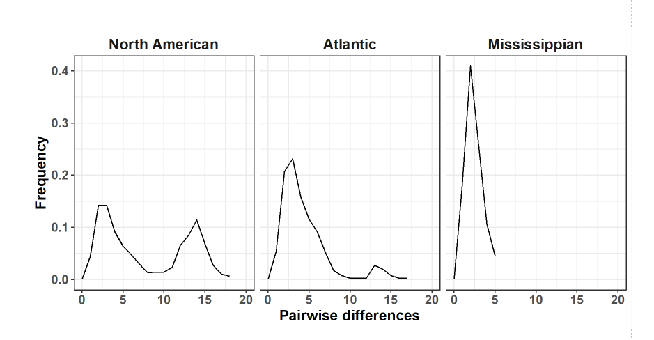

The second issue, the missing figure, is still a problem of course. Is there a way to fix that one as well?

2. You did mention a missing image, but I can see the same image in both Word and TextMaker

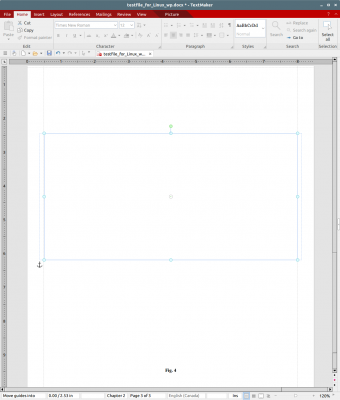

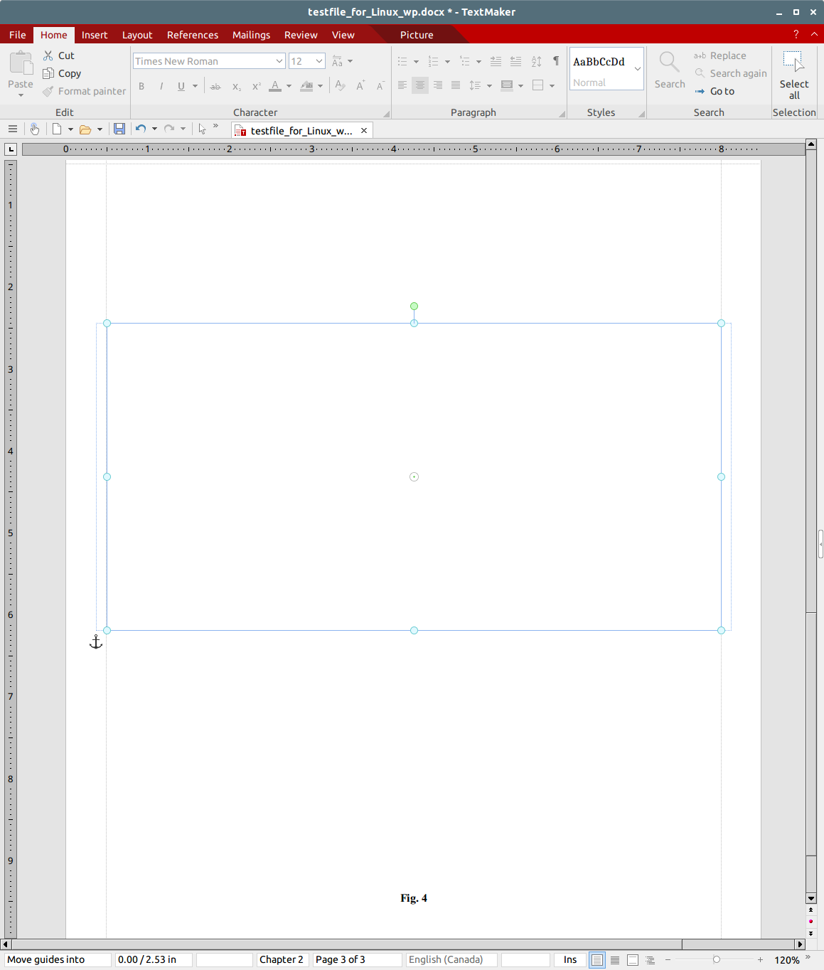

Re: .docx translation issues - spacing and missing image
You have the right image, but I checked again, and can't see it. TextMaker obviously knows it's there because it can see an outline of where the image should be (see attachment). Could it be a setting again?
Thanks for working with me on this, miguel-c. I really like the Softmaker Office programs and would love to use them instead of MS Office on Linux!
My apologies. I forgot to open it in Linux.
So, in Linux the image doesn't appear. The reason is because it's an EMF file and SoftMaker Office for Linux doesn't support those files yet.
Please convert it to PNG and insert the image again.
