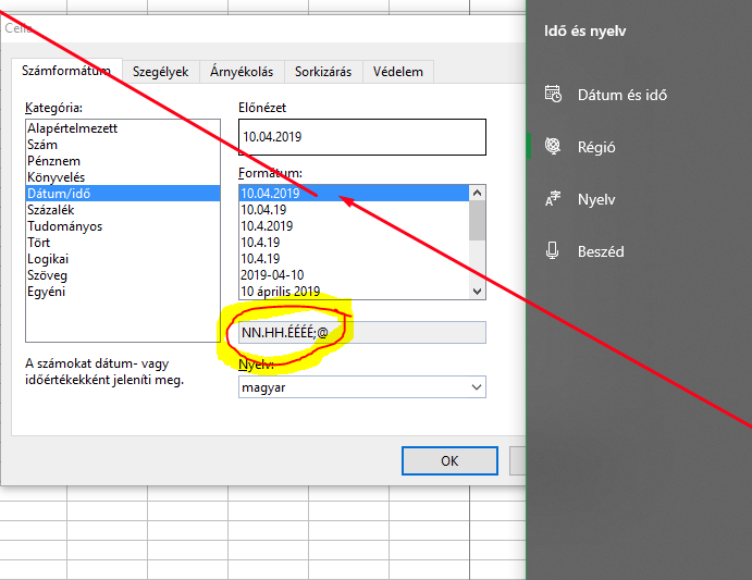

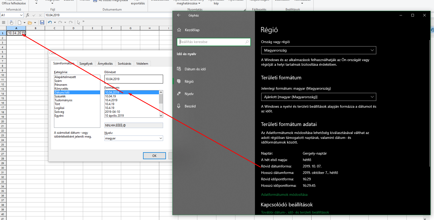

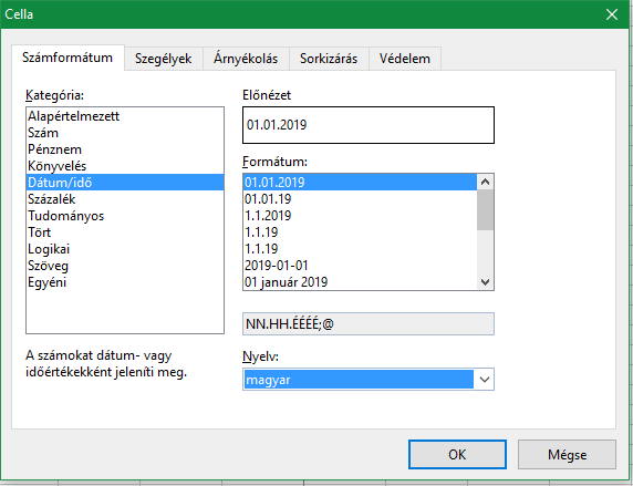

Hello,
The default format of date for hungarian is DD.MM.YYYY and can't possible to change.
When will be fix this BUG.
Thank You!
Re: PlanMaker 2018 Excel Date format
Hi, PlanMaker takes the date format from Windows. You can change Windows's date format on your Windows Control Panel, under Region.
tothcsaba
Posts: 3
Joined: Tue Oct 01, 2019 10:54 am
Post by tothcsaba »
OK!
I did it, but nothing changes!
Thank You!
Please click on custom (Egyéni) and change NN.HH.ÉÉÉÉ;@ to ÉÉÉÉ. HH. NN.;@
tothcsaba
Posts: 3
Post by tothcsaba »
I know, this is the solution for the problem, but you said some posts before "PlanMaker takes the date format from Windows". So, maybe something wrong with the PlanMaker code.
It's just a remark for the future builds, maybe take eyes on it.
Thank You!

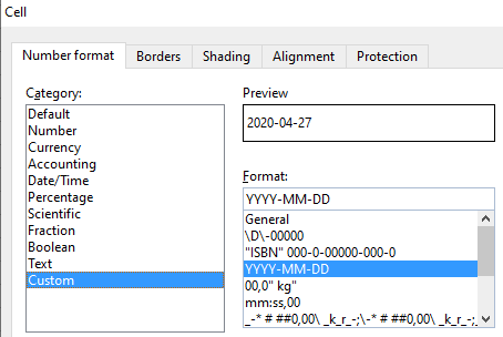

Found this great forum when starting to use FreeOffice.
I came from LibreOffice because I found it buggy. But this was not promising.
Anyway. I stumbled upon a solution.
Use a custom format:
It seems to work good. But you have to flip your mind everytime you write the date to the cell :)
I live in Sweden and Windows is set to YYYY-MM-DD but that does not change this. It seems it does NOT read system setting but uses their own.
