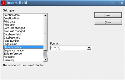

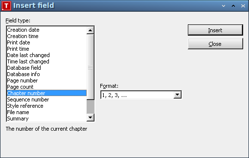

I read in the manual that you have to insert the chapter-number as a field, i.e. using the menu-command
Insert|Field

Michael Uplawski wrote: Mon Dec 10, 2018 9:16 pm I read in the manual that you have to insert the chapter-number as a field, i.e. using the menu-command
Insert|Field
Insert | Field is correct. Just insert the chapter number as a field in the header/footer and it should automatically appear on every page.
Note that while you can use numbered lists in headings, the numbers that appear there are automatically incrementing heading numbers and not the chapter number.
