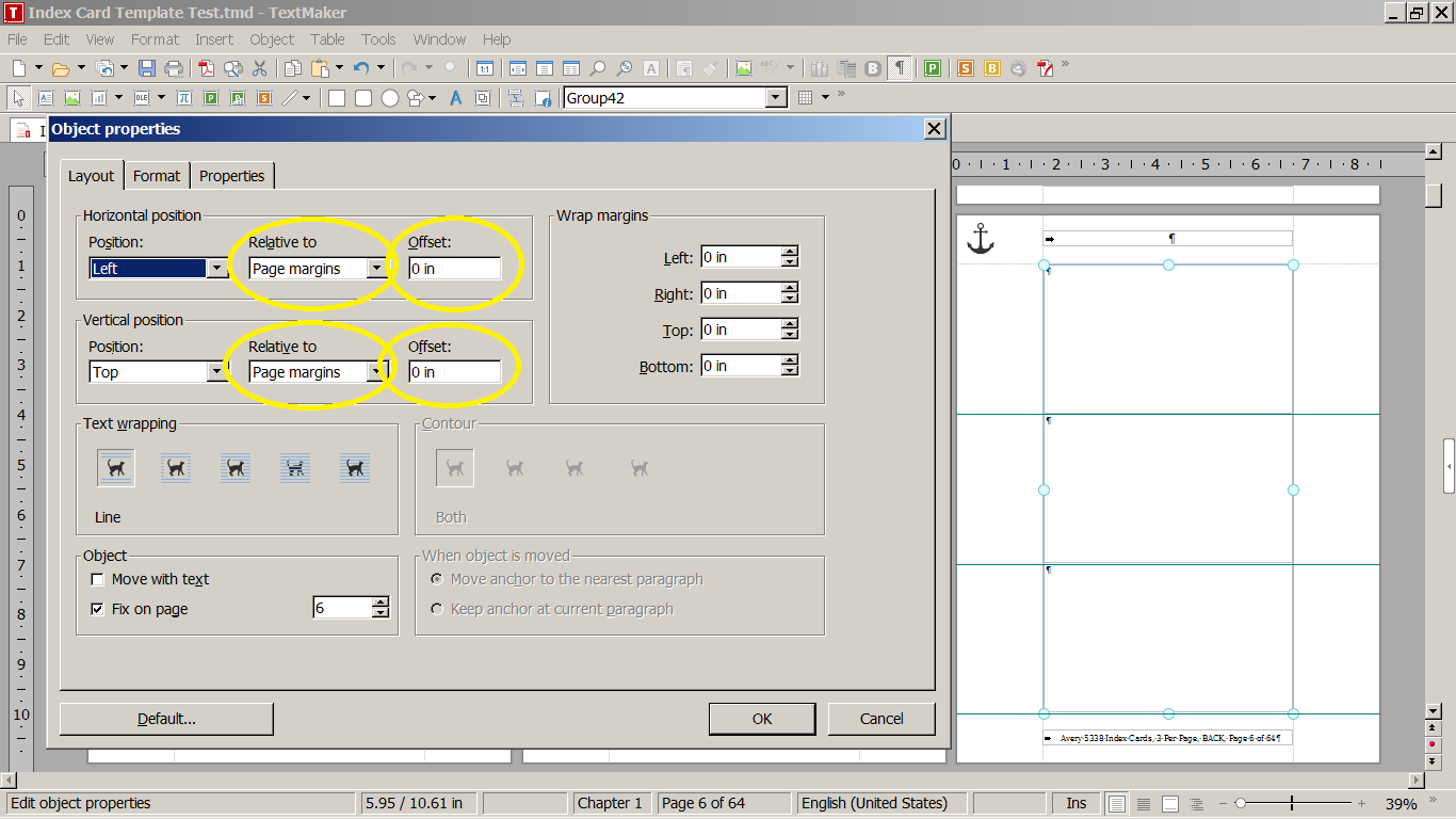

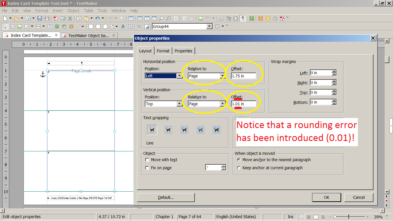

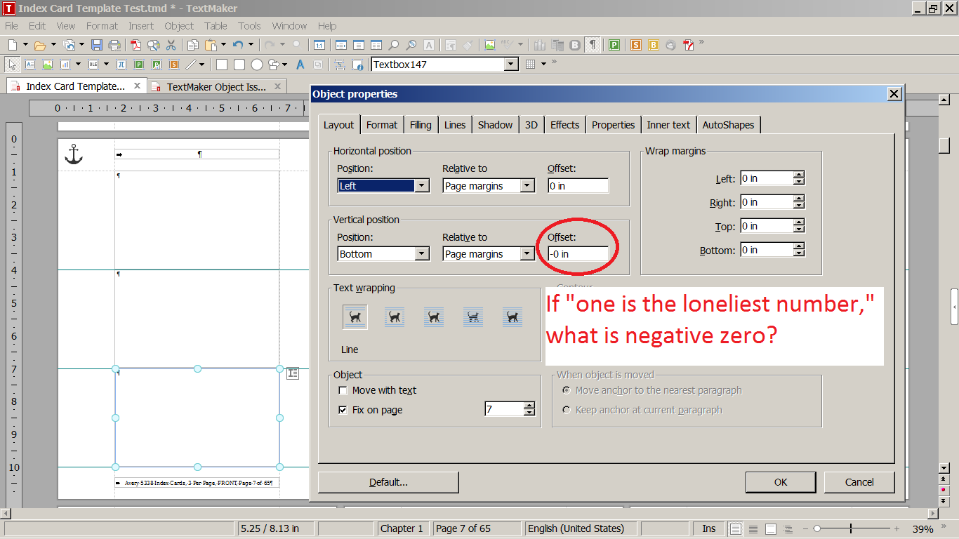

2. Problem: Object Copies ≠ Original
Even in object mode, TextMaker is not producing faithful copies of objects (see screen captures, attached). It’s close, but surely a perfect copy of a simple, empty object is an obtainable goal. Particularly troubling is the (presumably) rounding error TM is introducing.

Addendum: I've attached screen captures of a group of text frames (objects) that have been copied, the same group after pasting, and one of the text frames (objects) after it has been ungrouped. I can never get images to appear in proper order, but I'm sure you folks will be able to figure out which is which.
Also kindly notice that, in addition to the offsets of the copy being a bit off, they have changed from "page margin" offsets to "page" offsets. I wonder if this isn't another example of TextMaker's long standing problem with positioning objects ("Move Object with Mouse ‒ Object May “Disappear”," https://forum.softmaker.com/viewtopic.php?f=299&t=17635).

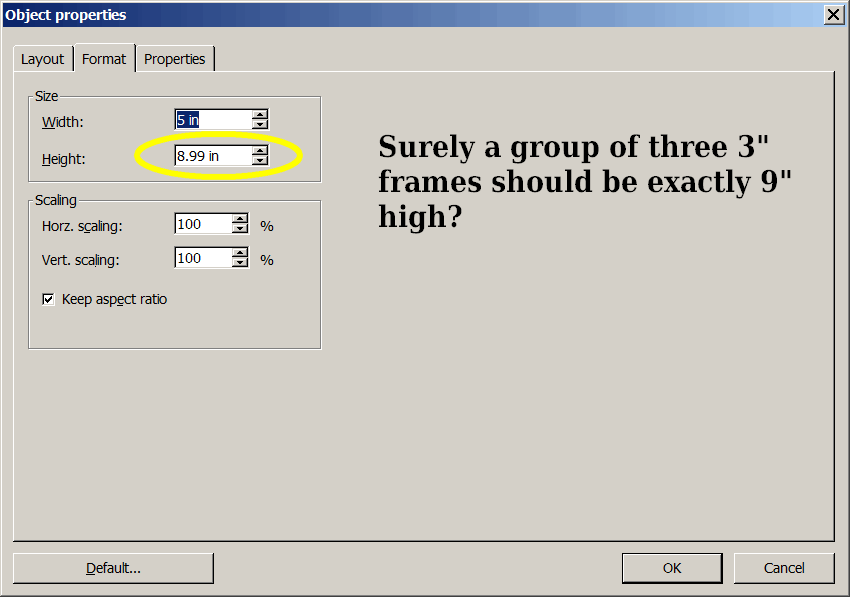

Re: Copying / Moving Frames
[attachment=0]Group Object Properties - Size - Annotated.png[/attachment]
- Group Object Properties - Size - Annotated.png (11.28 KiB) Viewed 62285 times
