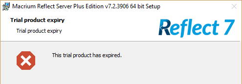

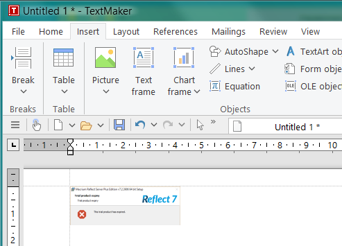

There was another problem - I insert a full-sized image (option with "frame" or without "frame")
but as a result, its preview is inserted

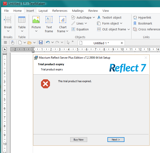

No, it isn't. The "preview" effect is somewhat baffling at first sight, but in fact the image is inserted in original size into the printed document; it is only on screen that it looks much smaller, because you don't see the TextMaker document in its original size on screen. In your above posting the image is shown in screen resolution (e.g. 96 dpi instead of 300 dpi), so it looks much bigger. When you change the zoom level in TextMaker via "View" to 500%, you will see that this is not a preview but the full size image.
The file 1.png has a size of 495x172 pixels and a resolution of 300 dpi, so the full size is 1.65'' x 0.57'', and this is exactly the size the image has on paper. On screen, as above, with a resolution of only 96 dpi, the same picture has 5.16'' x 1.79'' (and with a screen resolution of 72 dpi it would be 6.875'' x 2.39'') .
If you want a bigger image in your document, right-click the image, go to Picture: Properties..., tab "Format", and change size or scaling. Of course, with a scaling higher than 100% the image will lose some sharpness when printed, due to lower resolution.

:D Thanks for the answer! But until now, I normally inserted pictures, and never looked in the settings (there is always 100%). But I still found out the reason - this happens with pictures cropped at Faststone Imagе Сapturу. If it is cut in another program or not cut, the picture is inserted normally

TextMaker inserts all images with their original resolution, so I suppose that FastStone defined the resolution as 300 dpi. For a screen capture, this is obviously wrong. I don't know anything about FastStone Capture - maybe there is an option to define output resolution?
