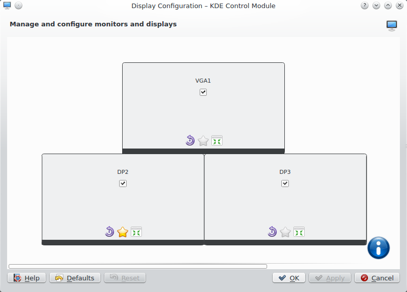

I could pinpoint the segfault to my multi-monitor setup.
Using 2 monitors next to each other presentation18 starts normally.
Adding a third monitor above presentation18 instantly crashes.
Monitor setup that yields the segmentation fault

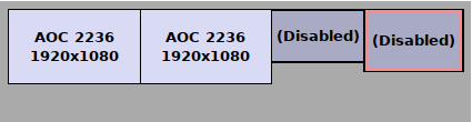

I have 4 monitors side by side. presentation18 crashes on startup.
Crash
If I disable two of my monitors, the program opens just fine.
Good
