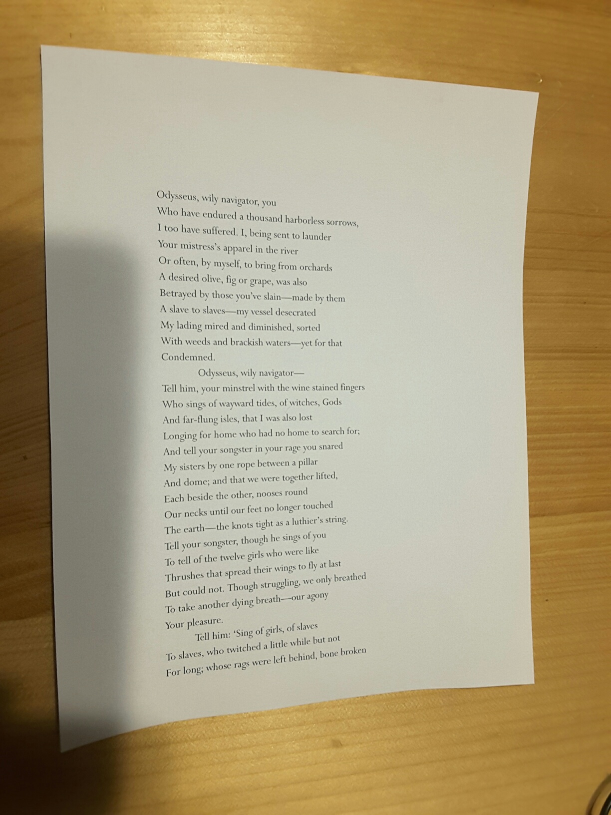

2.) The second appears to be a bug. When printing (and only with the first page) Softmaker seems to add extra white space to the top of the document, as if printing to A4 even when set to 8.5 x 11.

An image of the page is attached. The top and bottom margin should be the same. I've noticed this issue with all documents.

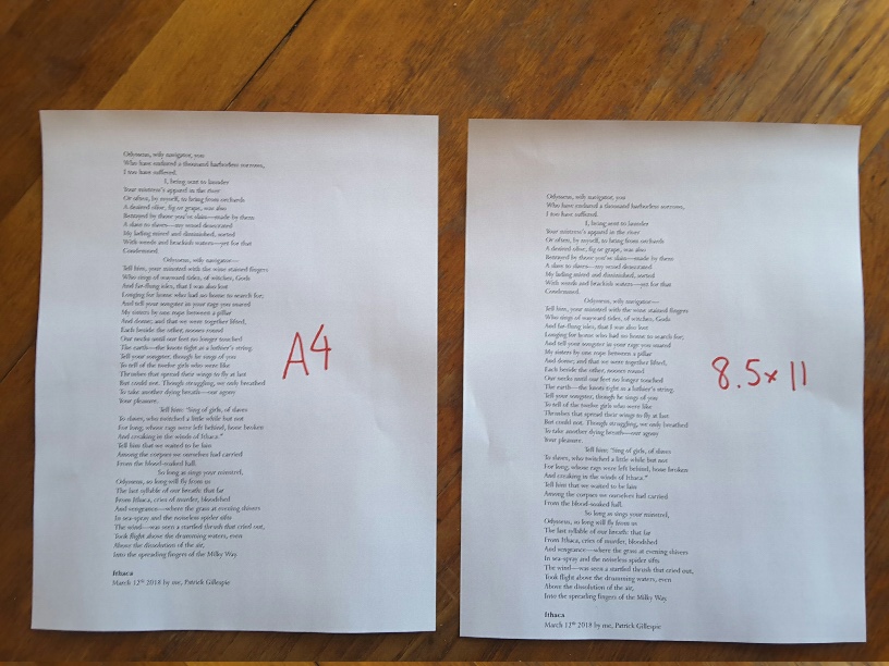

Yes, the file prints as expected from LibreOffice. I'm speculating, but it really does look as though SO is printing to DIN A4 when set to 8.5x11 (ignoring paper size settings).
I tested and see attached.
My paper size is 8.5x11. When I set the print size to DIN A4, the document prints as though to 8.5x11. When I set the print size to 8.5x11, it prints as though to DIN A4. (The red indicates the "print setting" size at which the document was printed.) So, in other words, when I print to A4, the document prints correctly (on 8.5x11 paper).

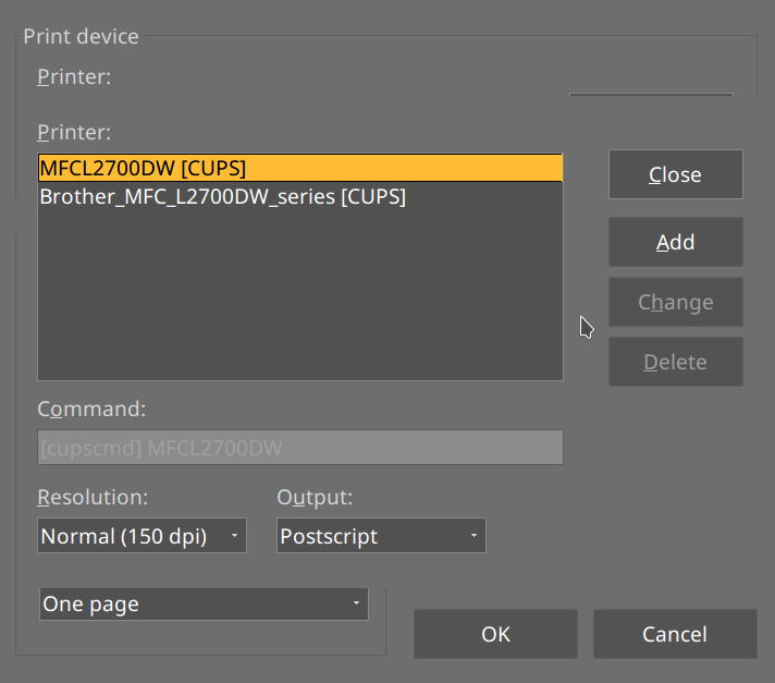

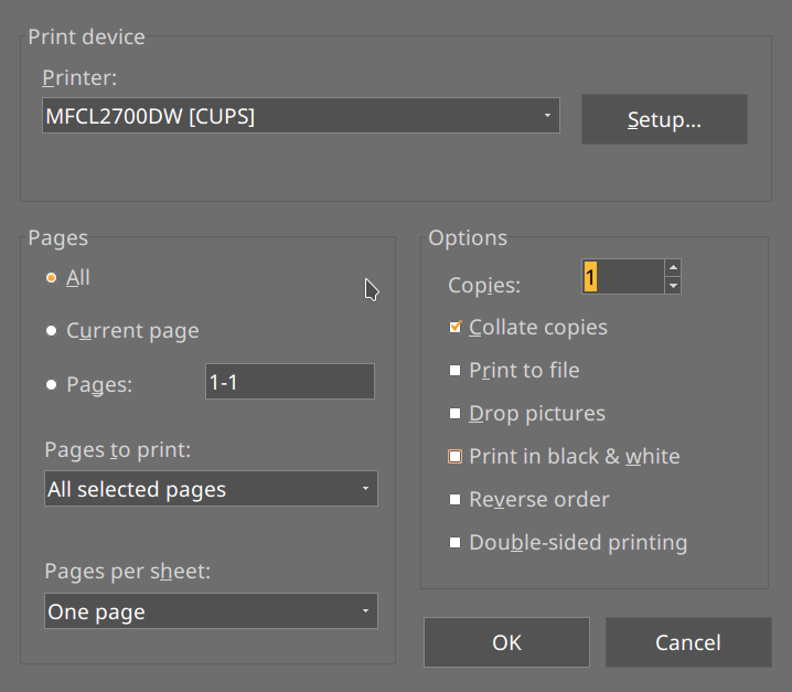

Yes, there's a checkbox for double-sided printing. But that's not the issue. The problem is that there's no way to control whether the document is printed on the long or short edge (Duplex Tumble or Duplex No Tumble). If I choose "Setup" from your print dialog box, that also fails to provide an option.
Re: Printing Bug & Double Sided Printing?
Attached are images of the Print Dialog Windows.
I will open a feature request to implement the option for long or short edge.vtpoet wrote: ↑Fri May 25, 2018 2:38 am Yes, there's a checkbox for double-sided printing. But that's not the issue. The problem is that there's no way to control whether the document is printed on the long or short edge (Duplex Tumble or Duplex No Tumble). If I choose "Setup" from your print dialog box, that also fails to provide an option.
