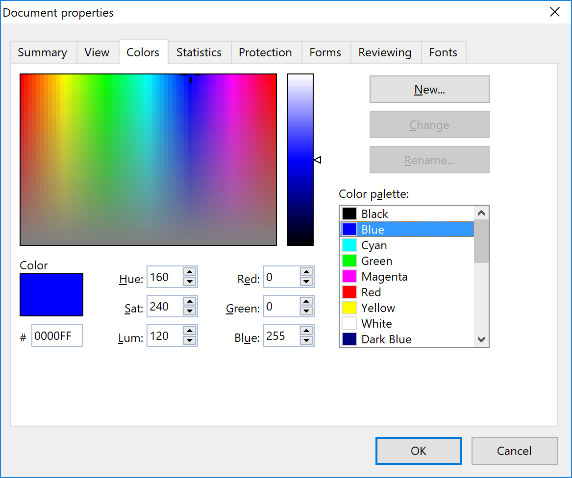

Hi Jossi - I am curious about your answer to the first question.
When I open Textmaker's File->Properties->Color Tab, I don't see any place where I can select "print page background".
This is after I created a file with a light gray background color and saved it.
Am I not doing this correctly?
Jossi
SoftMaker Volunteers
Posts: 1263
Location: Luebeck, Germany
Re: Made PDF on Jumpdrive and No Background Color
Post by Jossi »
Sorry, it's in tab "View", not in tab "Colours". My mistake. #-o
