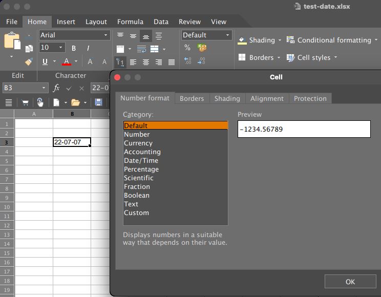

Thanks for sharing the file. I have checked your file and found that in your file, you didn't select the date format.
As you can see in the attached screenshot, the format of cell B3 is "Default".

I made another test file (attached), empty too except for 1 cell filled with today's date. The cell is formatted YYYY-MM-DD, which should result in 2022-07-20.
It still results in 22-07-20.
