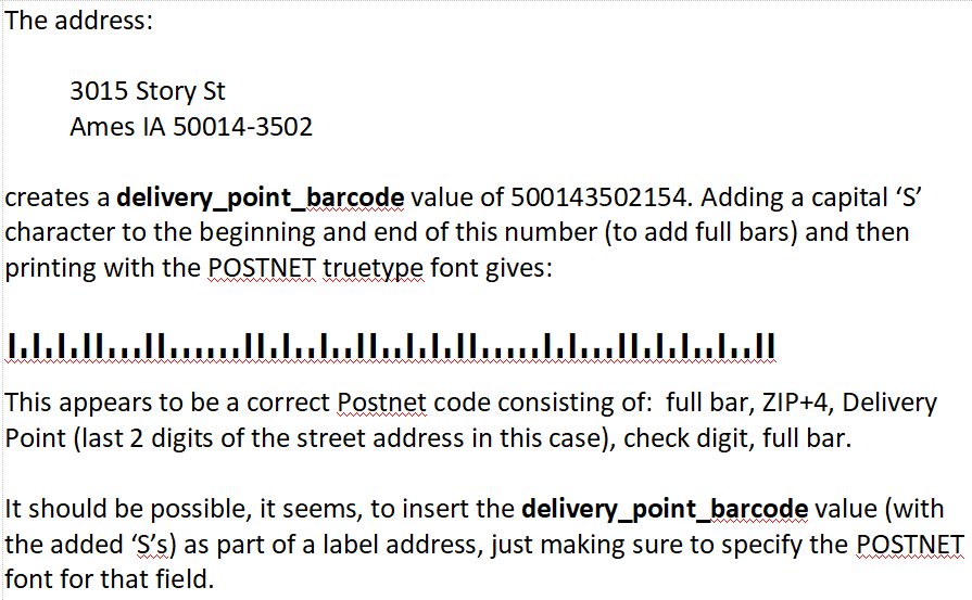

wbrells
Posts: 135
Joined: Fri Nov 18, 2016 4:09 pm
Re: Printing DYMO labels
Post by wbrells »
Jossi,
I think there is a fairly simple way of putting Postnet barcodes on an address label. The smartystreets.com web site provides a service that checks & corrects mailing addresses. That is a useful feature in itself, but as part of this process a so-called delivery_point_barcode value is created. After a minor modification this value can be printed using the free POSTNET true type font to create a Postnet barcode. I've attached an image showing a sample of this process. (Note: I plan to store the modified delivery_point_barcode value as an entry in my CSV datafile that I'm using to print Dymo labels.)
Wayne
Jossi
SoftMaker Volunteers
Posts: 1303
Location: Luebeck, Germany
Post by Jossi »
Wayne,
that's a great workaround!
Kudos
Jossi
