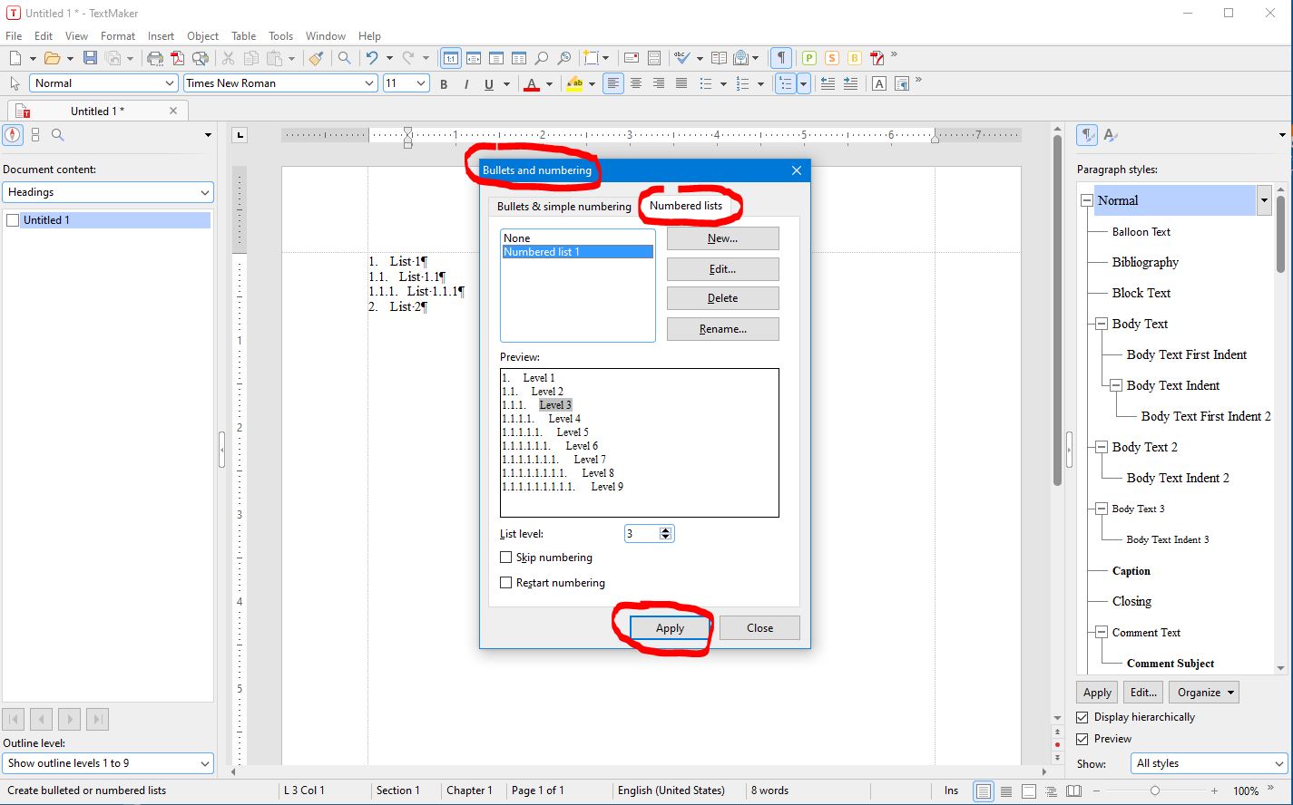

Thank you for your post.
Please select numbered list instead of numbering which is just beside to each other and don't put anything manually which interrupt the automated process of numbered list.
Please post FreeOffice related issues in FreeOffice forum only.
Posts: 737
Re: hierarchical numering - I can't do it, why?
Dissregard the fact that I use the classic menu system. The dialoge box should be the same.

yes ik, I did that right, as you show. Both the user-guide and your example only show level-1 hand-down. That always works. It's the nexr level I have a problem with. I attach two files. The larger one was imported as .ODT and hierarchy works. The small test one written in TM doesn't, levl-2 should run 2.1 2.2 then 3.1 3.2 I checked the paradraph formatting between both files and can find no differences. Only difference I can see is that the conversion was .ODT to .TMD and the new file is .TMDX so is that a problem?
