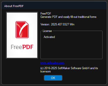

Please send a screenshot of "? > About" and a video demonstrating the crashes. There are plenty of free screen recorders you can get from the Microsoft App Store.

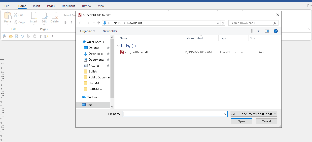

I have attached the requested plus the test PDF I was trying to open.
PDF_TestPage.pdf
(66.25 KiB) Downloaded 4412 times
FreePDF_2025-11-16_22-45-55.mp4
(266.96 KiB) Downloaded 4337 times

Thank you for providing the sample file and the screen recording. I have reviewed them but have been unable to reproduce the issue.
The symptoms suggest the problem may be related to your local environment, such as operating system file corruption or security software blocking FreePDF. I recommend troubleshooting these areas to resolve the issue.
