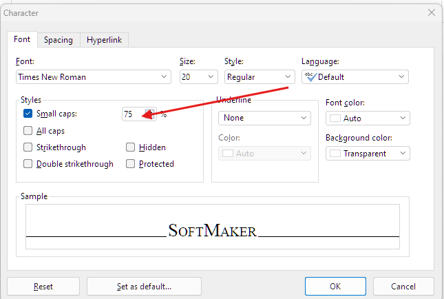

When using the program to generate small caps (rather than using a proper small caps font), I know we have to accept a slight difference in stroke width. I'm currently working on a document that need small caps at the start of each chapter, and the small caps are TOO small. To make them look right with 14-point type, I need to bump the small caps to 13 or 14-point. And then, of course, unless it's the top line on a page that changes the line spacing.
What percentage of the font height does TextMaker use for the artificial small caps? Whatever percentage it's set for, it's too small. Can this be changed in a future update> (If so, please issue the same fix for TextMaker 2021.)
Posts: 3791
Re: Small caps too small

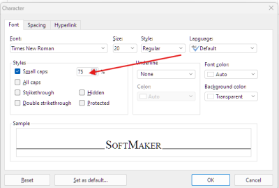

You can change the Small Caps percentage from the Character dialog box as shown in below screenshot:
