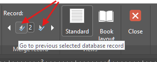

wbrells wrote: Tue Jun 17, 2025 2:16 pm Unfortunately, I don't see any way to view the merged result showing just the record that I selected from the Select recipients ribbon option...
To show only selected records, there are two different buttons, “Go to previous selected database record” and “Go to next selected database record”. You will find these buttons in the same “Merge record” group as shown below:
Show selected records only.png (8.51 KiB) Viewed 42280 times
