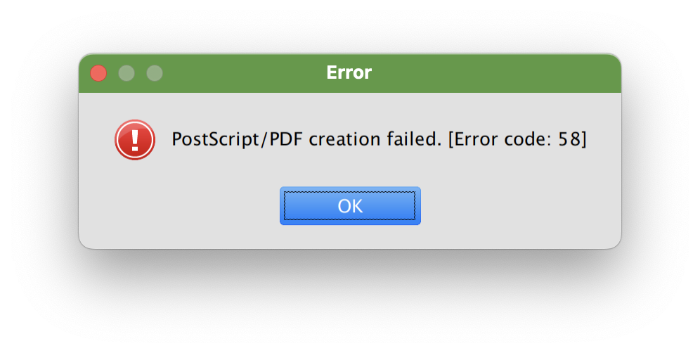

I am unable to open a PDF when the Blair font is used. Attached are the error messages I get when I try to export to PDF. I get Error code 58

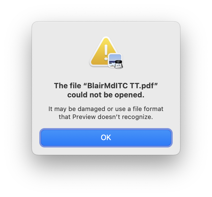

but the expected PDF appears in my folder. When I try to open this pdf file I get the other error message.
When I change the Blair font to a more standard one (such as Arial), the export to pdf works fine. What's the issue?

I've attached 3 files - a spreadsheet with Blair font formatting in cell A2 and the 2 error msgs when I tried to export to pdf.
The font at issue is BlairMdITC TT (came with PlanMaker).
Thanks.
Error code 58 msg
Error code 58 msg
Screenshot 2025-05-07 at 12.40.07 PMPDT.png (19.03 KiB) Viewed 57579 times
Cannot open PDF error msg
Screenshot 2025-05-07 at 12.41.06 PMPDT.png (24.83 KiB) Viewed 57579 times
