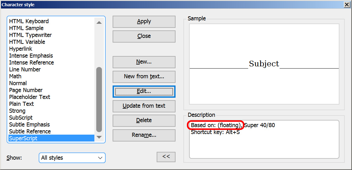

Per TextMaker’s online help system – the proper offline help system still being MIA – the formatting of character styles can be “based on” other character styles. Alternatively, one can base a character style on “(floating)” in which case the following is supposed to happen:
“If you select the option (floating) and you apply the new character style to a text, only the formatting attribute that you changed in the character style will take effect.”
(Aside: there is also the option of basing a character style on “(floating, paragraph),” but this option is not relevant in this discussion.)
Problem:

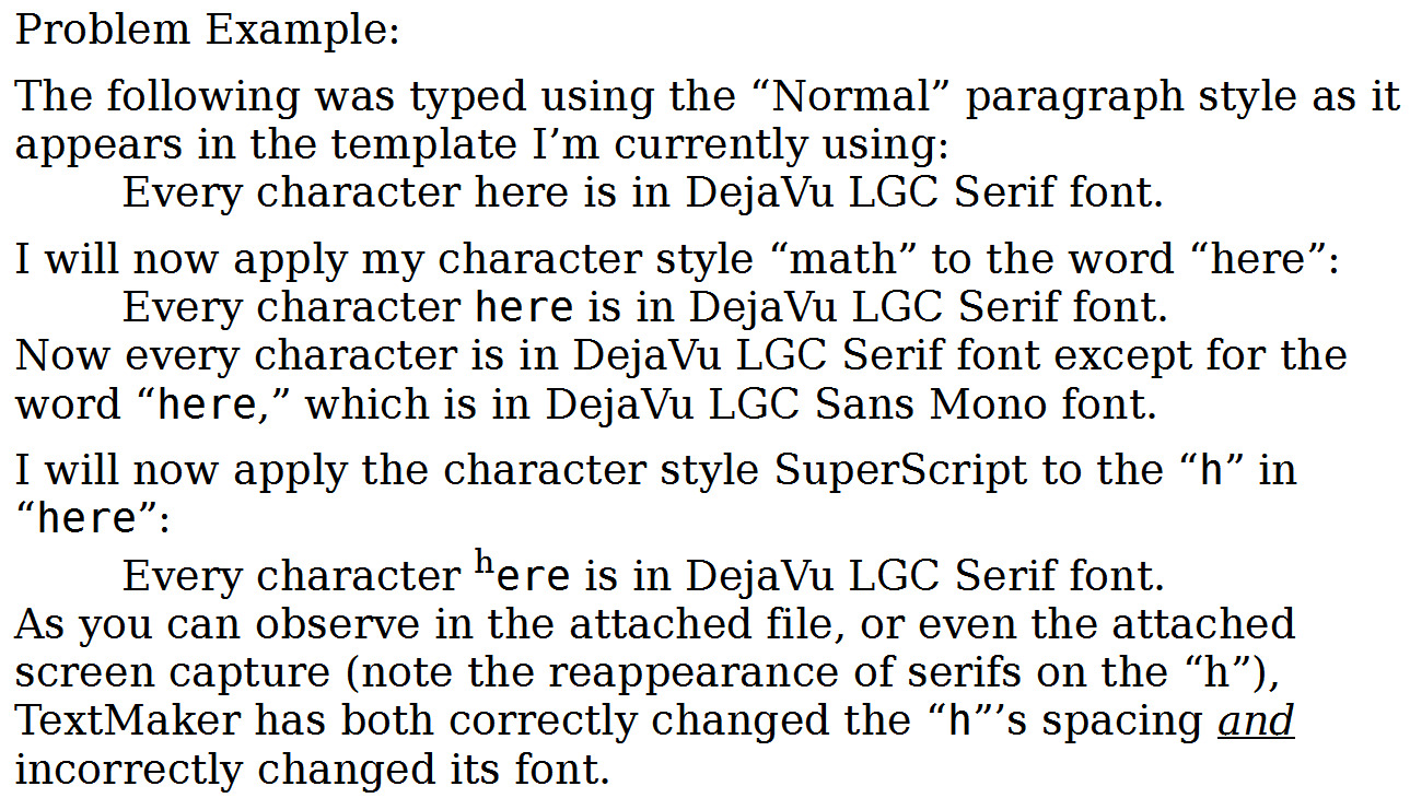

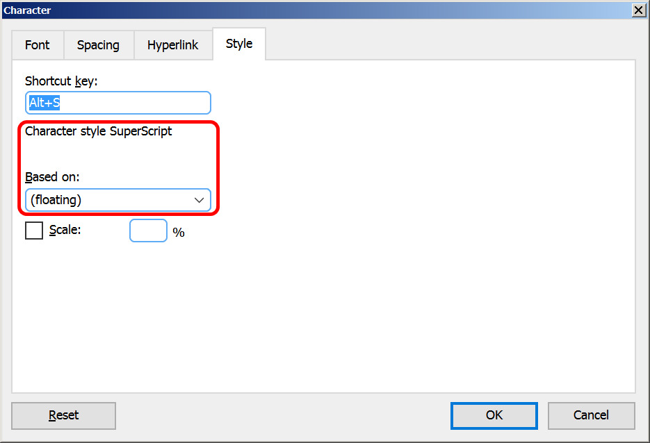

I created a character style “SubScript” and “SuperScript” so that I could subscript and superscript characters as I preferred, rather than as TextMaker prefers. Both character styles only contain changes relevant to subscripting/superscripting and are “based upon” “(floating).” Despite the use of “(floating)” and the assurances from the online (i.e. where it shouldn’t be) help, these character styles change the font too, if the font is not the default font of the paragraph.

This is because the character style "SuperScript" is begin based on "Normal" that is using the defualt font for paragraph. You need to set the desired font for the character style SuperScript to DejaVu LGC Sans Mono.
I tried doing th is with the file you provided and works and you need it to.

1. The character styles “SuperScript”, “SubScript”, and “Math” are all “based upon” the style “(floating)”, and not, as you wrote, “Normal”. Or at least they should be. 2. If I were to specify the font for the character styles “SuperScript” and/or “SubScript”, applying either to a character would also change the character’s font. As I might well want to apply subscripting and superscripting to characters in various fonts (e.g., fonts used in text, mathematical equations, etc.), this would be highly undesirable.
3. A character style that is “based on” “(floating)” that changes font characteristics unbidden would seem to be “verboten” per the documentation (as I understand the documentation). It is also rather inconvenient.

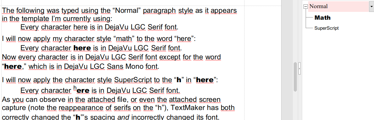

I took another look at your example file and simply changed the font for the paragraph style "Normal" and the character "Math" to something that allowed me to distinguish better the difference than a simple mono font. Everything worked as expected. (See attachments).
Fonts used: Basic Sans and Arial Black

If you examine the screen capture you produced, you will surely notice that, when the character style “SuperScript” was applied to the letter “h” in “here,” it changed both the font and removed the bold face. Examining the character style “SuperScript” as it appears in your updated TMDX file indicates – as I understand it – that neither of these changes were meant to have occurred.
In your TMDX file, like my original, the “SuperScript” character style does not specify a font nor a “style” (“style” this time being used to indicate bold, italic, etc.). Since “SuperScript” is (still) “based upon” “(floating),” and since the description of “(floating)” in the (regrettably) online (rather than offline) help system seems to state that unspecified options should not be applied by a character style when a character style is based upon “(floating)”, only the size and positioning of the letter “h” should have been changed by applying “SuperScript”. Your example, however, demonstrates that both the font and the “style” have been changed, indicating that either character styles are not being applied properly or they are not described properly in TM's documentation. Or did I miss something?
