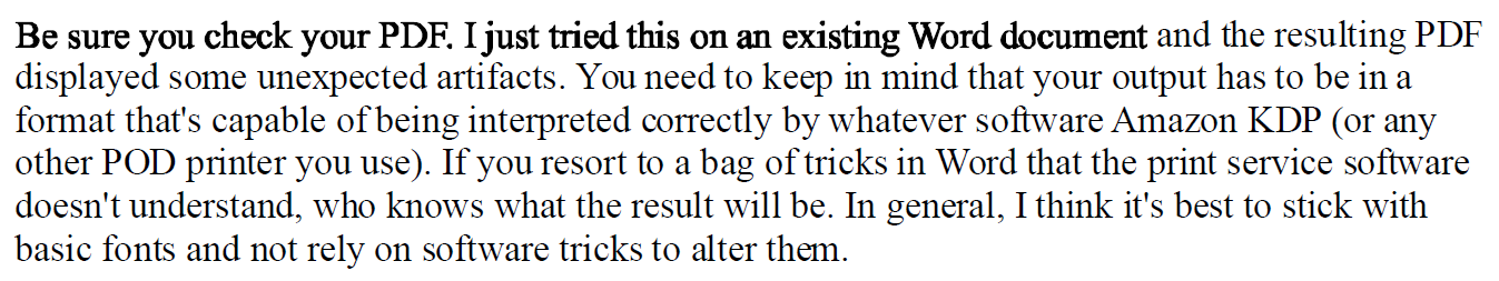

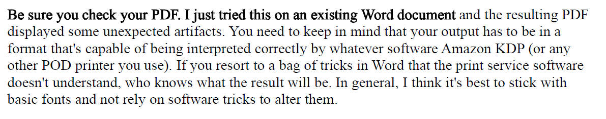

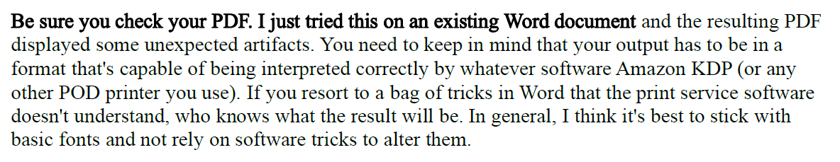

I just encountered an issue with rendering through the FlexiPDF virtual printer from Microsoft Word.
I participate fairly regularly on an Internet forum for authors. A forum member recently posted about not being able to find a font that seems to be a perfect match for a printed book whose interior design (typesetting) he wanted to emulate. The font was Garamond, but he said all the versions he tried looked a little lighter than the book whose appearance he wanted to match. He then discovered a feature in Microsoft Word that allows using an outline to increase the visual thickness of the strokes in a font.
This was news to me so, of course, I had to try it. I created a sample paragraph in Word, used the Text Effects feature to add an outline with a line thickness of 0.25 points, and then converted to PDF using three different methods:
  • Word Export to PDF
  • Print to the PDF using DoPDF7
  • Print to PDF using the FlexiPDF virtual printer
The quality of the base test (using the non-enhanced font -- in this case Times New Roman) was pretty much the same in all three PDFs. However, the quality of the "enhanced" text was best using export to PDF directly from Word, was worse "printing" to PDF using DoPDF7, and was considerably worse when "printed" to PDF using the FlexiPDF virtual printer.
In the interest of a direct comparison, all three screen shots were made with the sample PDFs opened in Adobe Reader XI.
Word export to PDF:
DoPDF7 virtual printer:
FlexiPDF 2022 virtual printer:
The quality of the "enhanced" text is worse in each successive sample. The degradation of the character rendering becomes even more apparent at larger degrees of enlargement.

Posts: 740
Re: Rendering problem on some PDF files.
SuperTech wrote: Fri Dec 06, 2024 8:15 pm Since other virtual printers are experiencing the same or even more issues, it appears the problem lies with the software where you tried this new feature. We recommend reporting the issue to their forum or support team.
Alternatively, you could wait for their upcoming updates, as they might address the problem with this feature in a future release.
But other virtual printers are not experiencing the same or worse problem. The version of DoPDF I used is several years out of date (I used DoPDF 7 -- the current version is 11.9.xx) and the quality was almost as good as the direct export from Microsoft Word. The quality of the virtaul print to FlexiPDF was significantly worse than either of the other two. All were printed using the same computer and the same printer, so why does FlexiPDF render the output so much worse?
