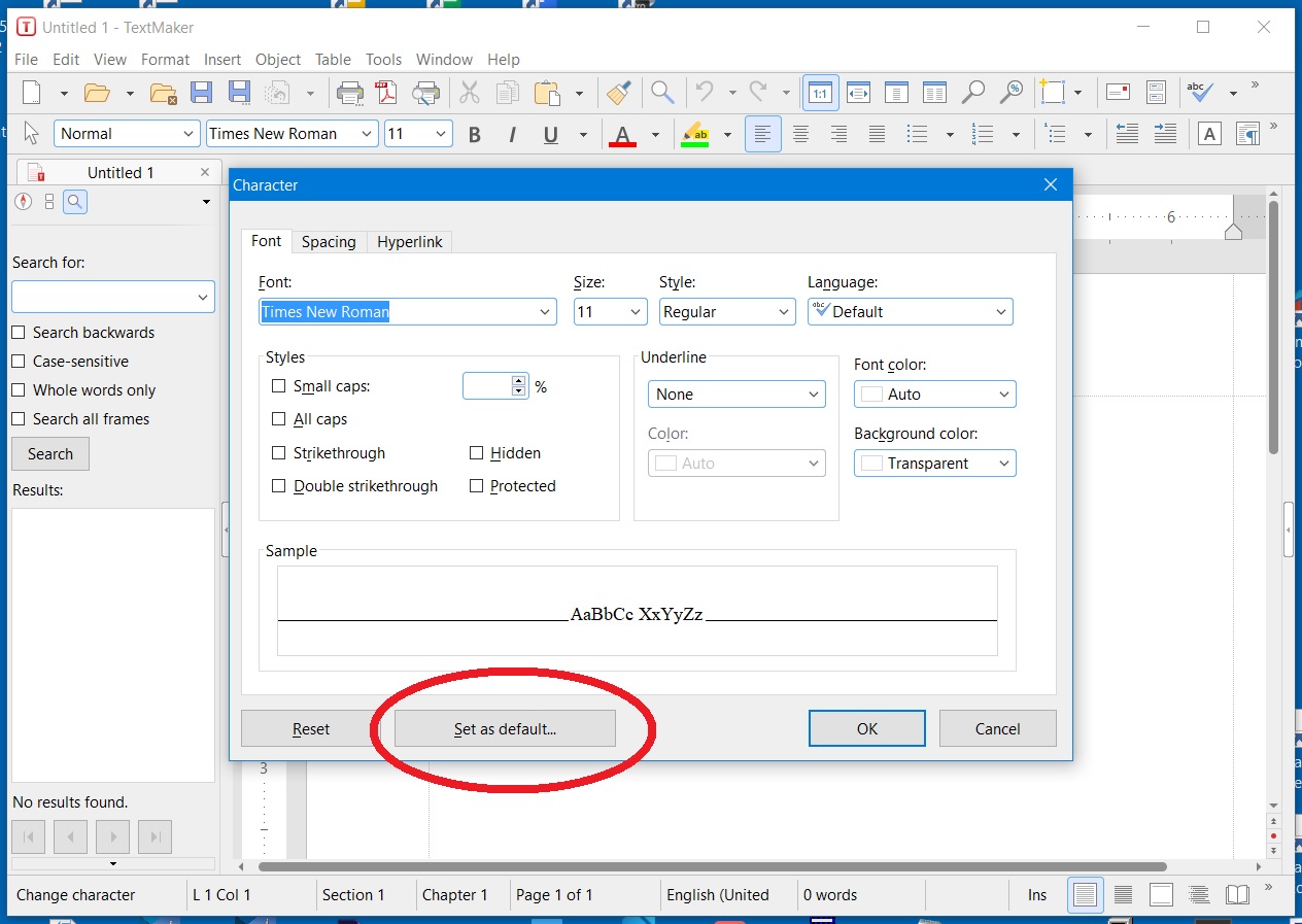

Posts: 740
Re: Using and modifying basic template for Textwriter
You can (and probably should) also change the default font to whatever you want the default font to be. In your document, when you have the dialogue window open to change the font, be sure to click "Set as default" before clicking "OK"
