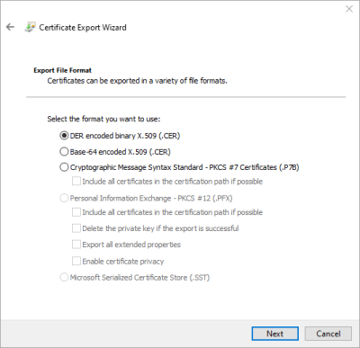

Thank you, but I can export certificate just like ...

It has no way of knowing because it is installed on flash drive. I can only export.
Re: How use digital signature in flash drive
I noticed on your screenshot that the option to export the digital certificate to PFX format is disabled, while the option to export to CER format is available, it suggests that the certificate you are trying to export does not have the associated private key marked as exportable. The PFX format includes both the certificate and the private key, whereas the CER format only contains the public certificate.

2249
Posts: 19
Joined: Mon May 29, 2023 11:47 am
Post by 2249 »
Thank you.
In "Details" I have just "Authority Key Identifier" with "KeyID",which includes a lot of numbers and letters, but I don't think this is it Private Key.
