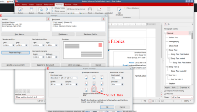

Hi Martin:
Yes I am using the regular print function. It's this one:
The reason I am sure it's a printer problem is I used Mailings -> Envelope but left one letter sized paper in the tray. It printed one "envelope" on the letter sized paper and stopped. It worked as it should. So it appears to be the printer is looking for a 11 inch long piece of paper and is instead being fed a 9.5 inch long envelope. That is just a guess on my part. I also think part of the problem is that my Linux distribution, Devuan, has a printer configuration tool that won't allow me to use the supplied *ppd that came with my printer. This tool insists on configuring the printer. Normally, I configure the printer through cups using https://localhost:631. The printer setup tool overrides my CUPS configuration and instantiates its own version. That version idoes not use a *.ppd file.
In any event this is a trivial work around: press the orange button to cancel the job.
